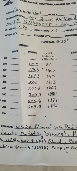

not sure why the flow went bad after .300 lift. the stock intake valve was 1.87 new one 1.94. want to get another 10 cfm after .300 lift. with a stock intake valve on stock heads they make 190 cfm at .500 lift.

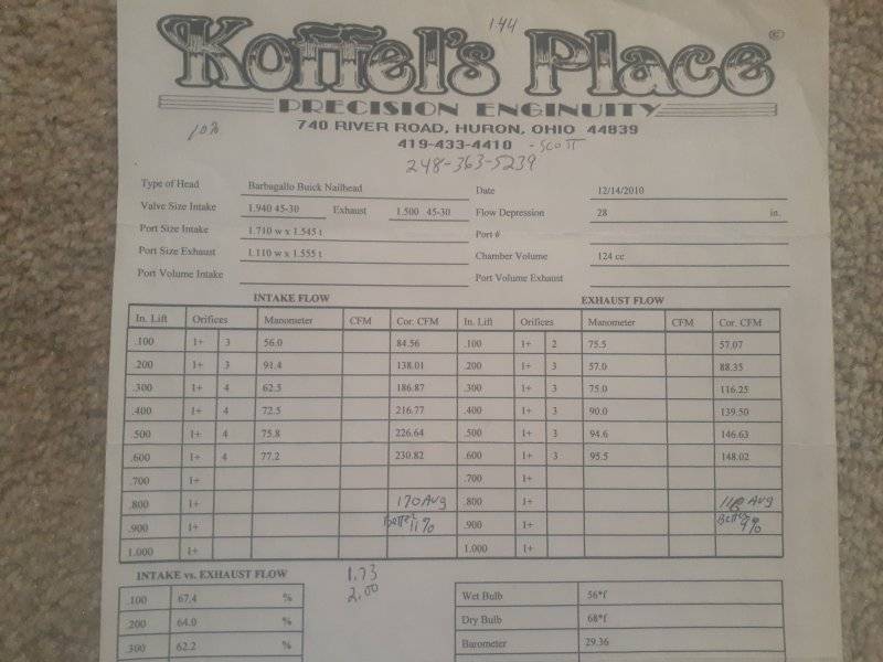

looks like Koffel was a better nail head porter then the nail head porters
looks like the 400 lift is good just after that gets bad.

just weird how it nose dives even going down at 550 lift.
If the head can not flow it most likely creates a turbulence imbalance is my best guess. The intake could very well play into it. The numbers show that there is a flow restriction or corruption of flow with the intake.

they already been ported with bigger valves the flow numbers are good to .400 lift. koffel get the right numbers

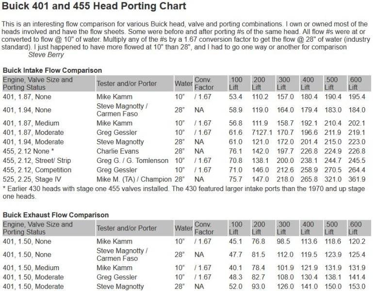

Koffel's numbers are someone else's porting and a different flow bench. So send your head there and see if his numbers are different than what you have now.
what ever flow bench the .500 lift above numbers will never be good
wondering if the intake valve just needs to be more un shrouded. the exhaust numbers are good

If you carefully compare the Koffels numbers…….to pretty much anyone else’s numbers, for most any cylinder head running a similarly sized valve(1.94), you’ll find something that raises a red flag(for me anyway………and is something I have never come across in flow testing heads for 32 years).
