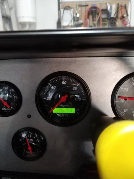

Mile 1 back in the garage and l find 3 small puddles of antifreeze on the floor. I remember reading about this awhile back and the recommended fix was replacing the bolts with studs and using the Red Permatex RTV Silicone. I'm wondering why studs would be better for sealing than bolts. Any tips appreciated
