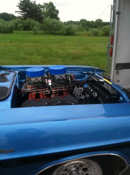

Dual Dominator's on a tunnel ram with headers on my Hemi with no choke. It fires right up & idles nice instantly. Of course I don't drive it in the winter though. LOL. Almost seems fuel injected.
