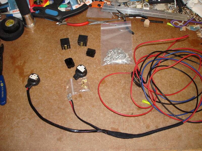

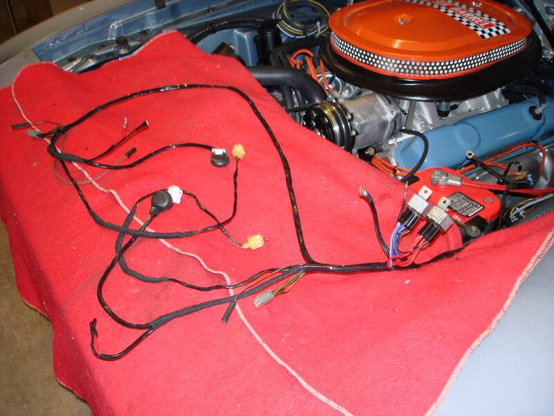

Stock wiring, 50+ years down the road? Even the stock Incandescent tungsten bulbs (4-10amp potential total) suffered from connection resistance/heat build-up over time. Not sure you can get the original bulbs anyway, reasonable. Stock or not, do the relays, if the ammeter is present, make the load connection at the alternator stud. Any headlamps will benefit from relays. If you have any electrical skills at all, don’t need to buy a kit. Can be put together with a small investment.
What would I recommend? I run Hella E-spec H-4 and H-1s. On high beams total of 540 watts (40 amps) through the bulbs and 300ma (relays primaries current draw) through the stock lighting switching and wiring. For various reasons, not a fan of the current LED offerings for these old cars.
Doing it yourself to install relays is fine. If you have the correct crimpers and how much you value your time to do it, get after it.

A part number for this system? Not a kit with a single part number. Here are the lamps I use for the four lamp systems, including upsized bulbs.
https://www.summitracing.com/parts/hla-002850811
https://www.summitracing.com/parts/hla-002425831
https://www.summitracing.com/parts/hla-h1-100wtb
https://www.summitracing.com/parts/hla-h4-100-80wsb
Other components source individually.
And I agree, if you don’t have the skill level necessary or the correct tools for this kind of electrical work, better off to buy a pre-made relay kit.
