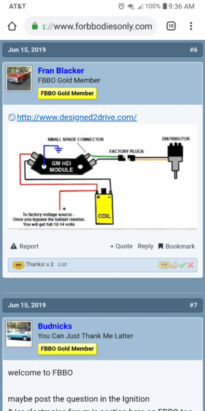

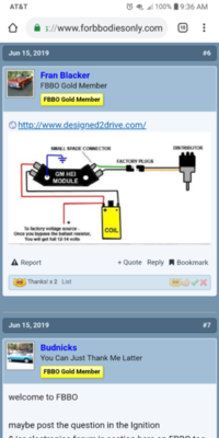

Update: I got fed up with messing with the red hei big cap dizzy.
I have a new coil.
New ignition control module (GM 4 post)
Factory mopar dizzy with a new pickup.
I followed every step from the picture..
I have the brown cranking wire (balast removed) to positive post on coil as well as the blue "run" wire.
Both show to have power, I also have 12 gauge wire from ICM to the positive post on coil for a total of three wires going to positive post.
Grounded from the ICM to neg. On coil.
Fired up yesterday, was starting to time it, it petered out and hasn't started since.
Brown and blue (crank and run) wires both have power, I installed the new coil and magnetic pick up at this point and I have no spark.
I'll have power at the positive post on coil while cranking, and with the key in "on" position.. But no power to the coil to dizzy wire during crank or on.
I've used both an accel coil and a mopar performance coil and get no power to dizzy.
Any suggestions?
