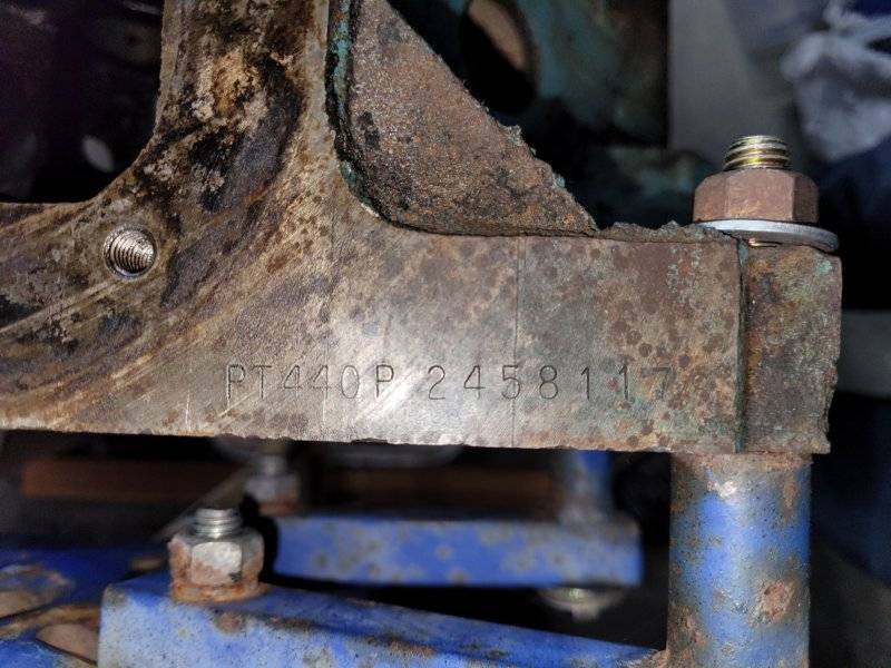

Happy to help where I can. The casting numbers on the side of the block would be another way to identify what you've got. There should also be a serial number along the rear oil pan rail near the starter.
Here's an example from my 440
