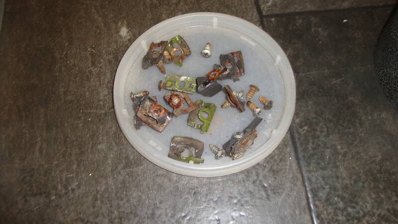

I assumed screws. I removed my front & back windows, and those clips were all held with screws. I even handed him the ones i still had. And said, if this were originally studs, someone would have had to grind them off, and drill all the holes. He still says studs.
If you chose screws. Dont forget the dumdum on the threads Seals against water leakage.

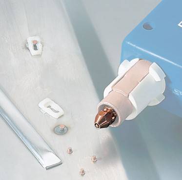

seen these?
Not quite that advanced yet. I do have a similar device for dent pulling. You weld the tip to the dent where you want to pull and there is a slide hammer on the rod. You pull the dent and then break off the weld.
Your stud gun can install clip retainers.... It can also be used to heat shrink metal...
It's been well used in the last 10 years. They are inexpensive now but were a major investment when I got this one.
It's a great tool & yeah the one I've had access to was bought back in the 90's & it was $$$$...
