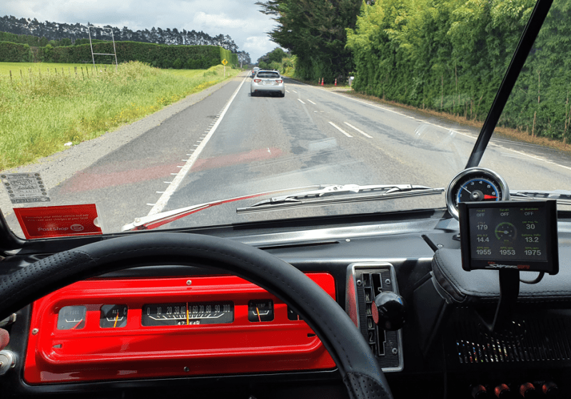

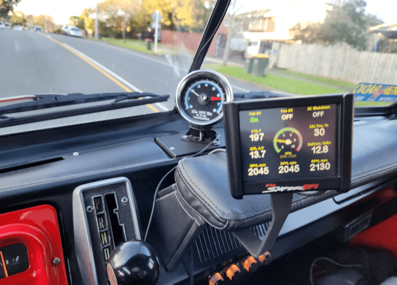

Dark Brown wire off the 10 pin connector. It was the only wire off that connector I used. I'm using an Autometer.

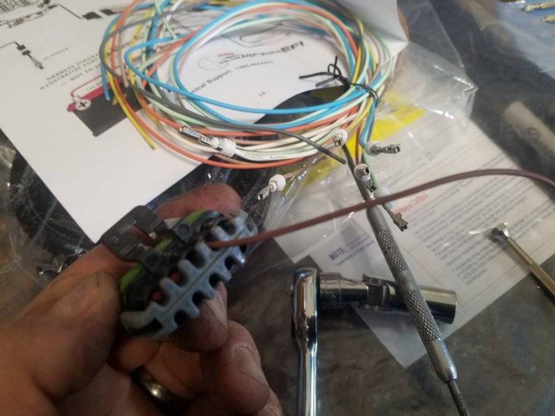

I'll have to check and see but the brown wire seems to be what I used for the tach signal. Its in the supplemental harness which is also for electric fans and what not. I have to download the manuals real quick.
I am using a Sniper EFI hyperspark system: distributor, ignition, and ignition coil. I was wondering if I could use a Sun tach or Stewart Warner tach. I'll have to dig deeper about that brown wire. And what kind of Autometer are you using? I know they have a few in their line up that looks vintage
That's great! Which wire are you using and where does it come from?
The brown wire from the 10-way plug - blue and green are used on the ignition on the same plug....nothing else used on mine.

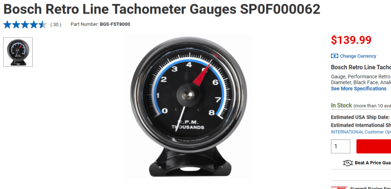

About how much did that repro Sun tach cost?
