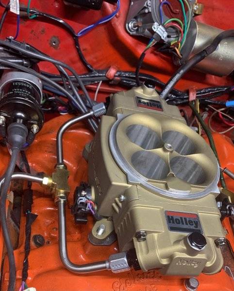

Holy **** just finished most of my wiring for my X-Flo. What a major PITA! Especially trying to hide everything and make stuff look neat. Felt like I had to rewire the complete engine bay especially tying everything in with my electric fans and vintage air. Still like a few more things like hooking the ignition box up inside the car, fuel tank, wires and filter.

Here’s mine, I’m working on fabricating the 3/8” stainless hard lines still.
