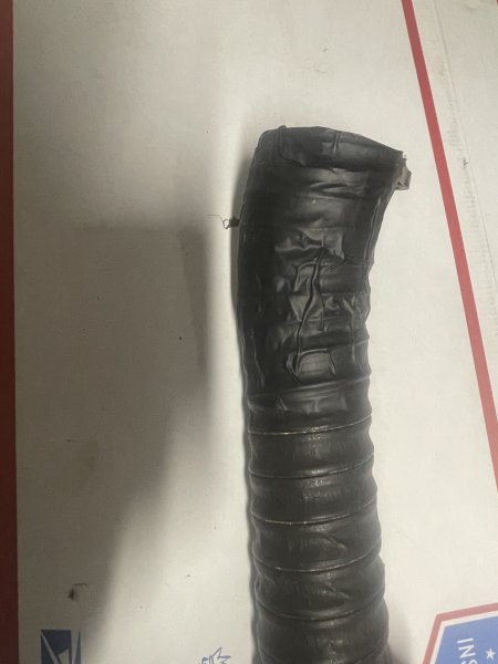

I went down to the local parts store and got some black vinyl wrap. Used the black vinyl and a heat gun to fix it up. Worked pretty good for my 65 dart.

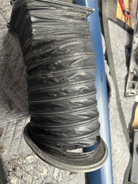

I haven’t completed mine yet. My duct was full of tiny holes so I found some flex duct online to replace it. Gonna have to do some manipulation on the square end.

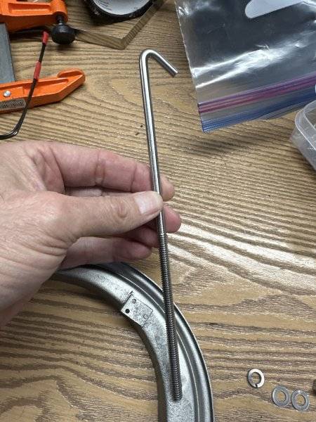

This connects to the cowling with “j” bolts. No one makes them, but I purchased a set of battery hold down j bolts that I will have to shorten and possibly re-thread. I’ll try to get a pic when I go back to my shop.

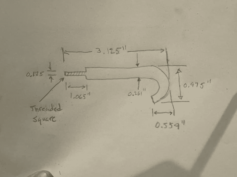

Here is what someone on FB posted as to the correct size.

Will have to be shortened considerably but the hook hopes inside and over the cowling. These are battery hold downs purchased on Amazon.

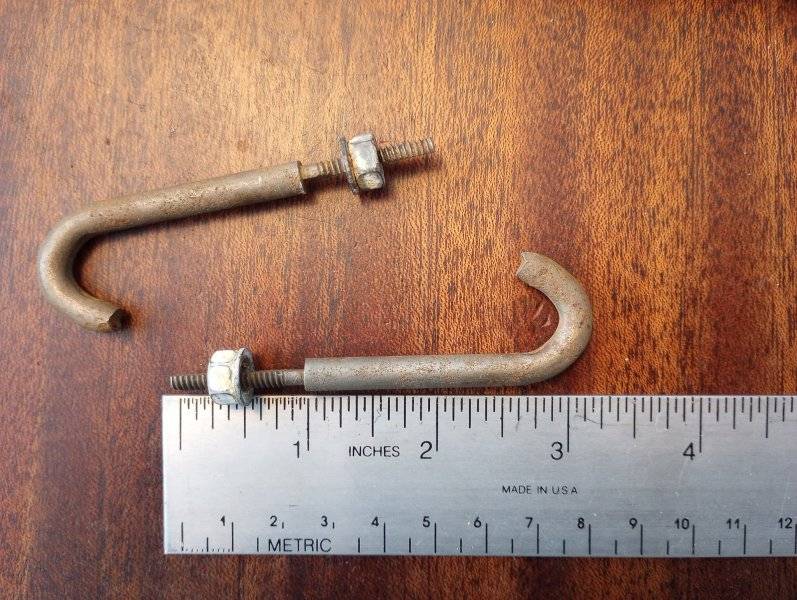

These came off a 67 b body. Look similar to the diagram above.
Do you happen to have any phtos of how this is connected at the cowl? mine is in pieces and i have no idea what i need to re-connect it. thanks muah
Don't have a pic but i think the j's hook over the inside edge of the cowl opening?? and the threaded ends go through the holes in the oval part of the flex duct.
That's it. Good pic showing original Unfortunately I am not aware of anyone making these so if missing have to fabricate on your own
