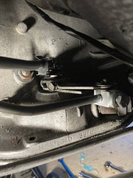

Kind of a noob to 727 shifter and kickdown linkage. Going through reconnecting my 70 RR steering column and column shifter I noticed that a lot of my linkage is loose where they meet at joints. When hooked up, I can kind of bounce each joint a bit. I’ve been staring at manuals and posts but can’t seem to find too much info. I know my car has a 68 440 stamp so it’s not original to the car. Just wondering if this is acceptable? Thanks!

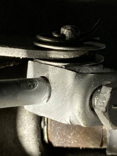

I think the washer goes on top there below the clip.

Thanks! In the pic the trans shifter from column just lifts up and down even when all hooked up. I guess I’ll accept it. Thanks again!
It' very important that at the shift lever on the trans that the linkage makes a very firm connection. The shift lever into the trans must be tight in the correct position.
Shim the linkage at the selector lever with a flat washer in addition to the spring washer you already have. those spring washers need a flat surface on each side of them to work correctly.

Thanks! Makes sense!
I guess there needs to be some flex in the linkage for motor / tranny movement.

You can weld the hole in the bracket and re-drill it to the correct size, or (what I did) weld a washer on both sides of the linkage flat section to create a nicely tight and centered hole.
Only the spring clip need to open up a little more to overcome the additional thickness.
Mine went from sloppy to snug after this.
