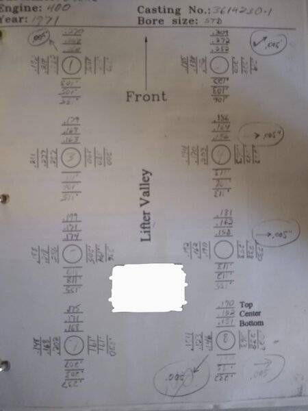

How much can this block handle based on the sonic check results?

I have a 470 in my 70 Coronet that I built in 2002. It's a pretty mild build (238/244 hydraulic cam, ported 452 heads, 10:1 compression), but it needs a refresh so I was going to possibly throw in a 4.25" stroke crank and some Trick Flow heads and go for 650 hp or so. I just found the sonic check results for the block from 2002 and I'm not sure the numbers look very good based on what I've been reading. How much power/torque should this particular block be able to handle? (it's a 1971 400 block, 230 casting) Should I start scouring junkyards to find a better example or will this thing be OK?

Seeing the results are that old I would have it rechecked. Technology has come a long was since 2002.

I may end up sticking with the 470. One issue is I currently have flat top pistons which would push the CR over 11:1 with Truck Flow heads and I can't find any dished pistons that have the right compression height for my 6.385" rods. Another issue is I'm running a cut down OEM 440 crank and I had heard they don't hold well to 600+ horsepower. I figure if I need crank rods and pistons I might as well go bigger to keep the converter and gearing more mild. I'm just wondering if this is the right block for this plan.
