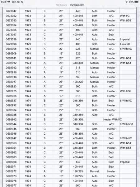

http://www.mymopar.com/radiatorspecs.htm
No pics for you, but here is the complete radiator list. :thumbsup:

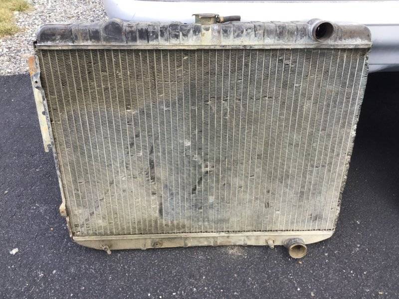

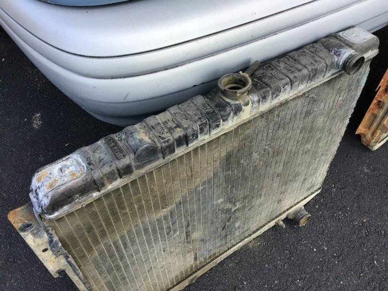

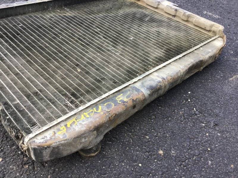

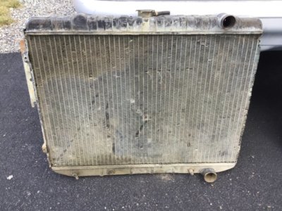

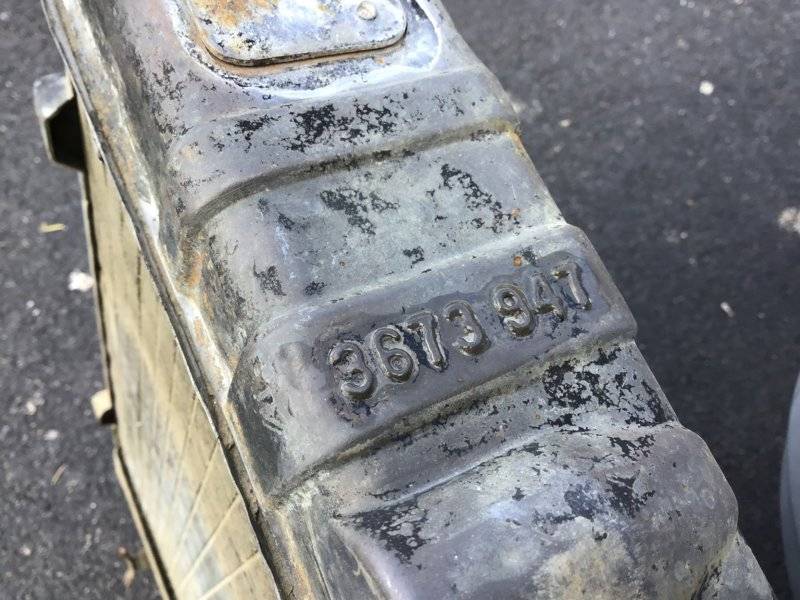

Here are pics of a 1973 440 radiator # 3673047 it is 28” wide, short top tank with the bulge on top. Could be the same design as a 1974 but I don’t know for sure.
In the chart above what is the meaning of with I/C ?
9CCAEBE9-2632-4478-B5BC-6E0223EA6FB9.jpeg 17C0E3EB-4610-427F-B5BD-7773336FF124.jpeg 73BE1BB8-2DC4-469C-9F91-69D47473E21D.jpeg 6DCF5D48-6424-48F8-86E2-2D8815A84837.jpeg

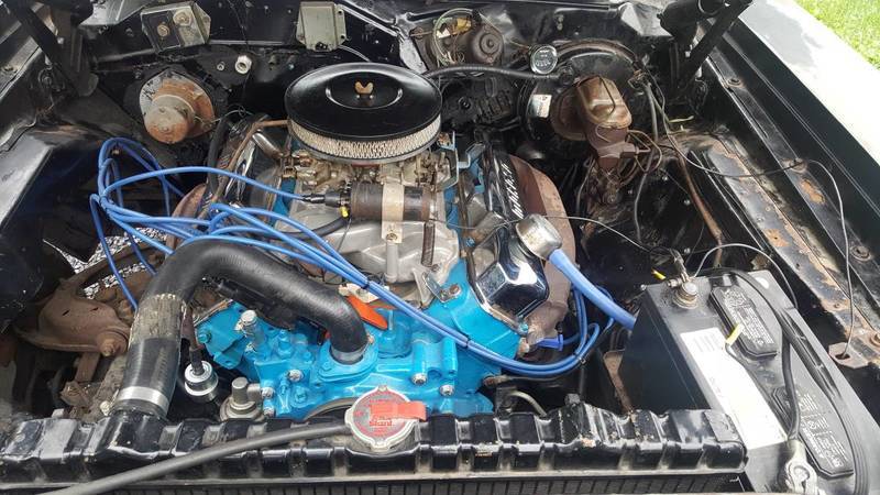

Here's a picture of what's in there. Yeah, no markings, but has the factory-looking mounting brackets.
