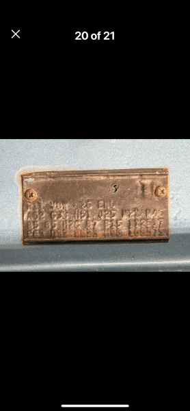

Not sure how legible…. This says when built?
Have you searched for the build sheet in the car?
SCHEDULED build date. Not necessarily the exact day it was built, but yeah, looks like an "early" car.
Agree with B15 being Nov.15, '68.
If the vin ends in 112537 that would also indicate an early car ( vins started at 100000).
