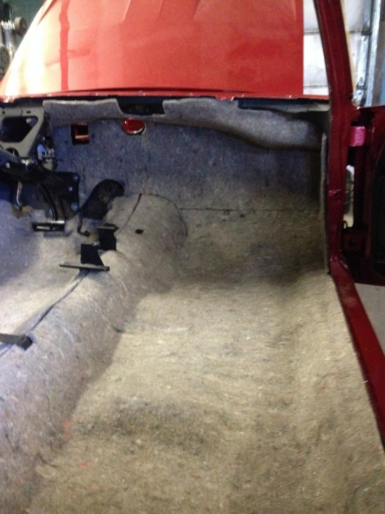

This is not my car in the pic but this is an automotive underpad (jute pad) I am considering for sound deadening.. I'm going ahead and using it behind the dash while the dash is out and probably going to have some cut out to install next time the interior is out of my car.
My 68 RR had the heavy pad like that and was very quiet inside and I had a comparison because I had the 70 at the same time and drove them both for several years.
The 70 had NO insulation what so ever .. just some cheap carpet pieced together with no backing.
Night and day difference.
I would tint if I could, it does make it cooler inside. Like the jute pad. don't know if I want to go that way or the other floor insulation products. Your thoughts?
The guy who did the Charger in the pics has used Jute pad in several of the cars he's done and claims it's a way better sound barrier than the other products for a much better price.

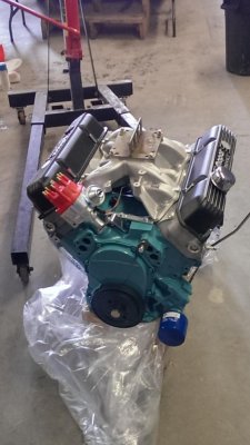

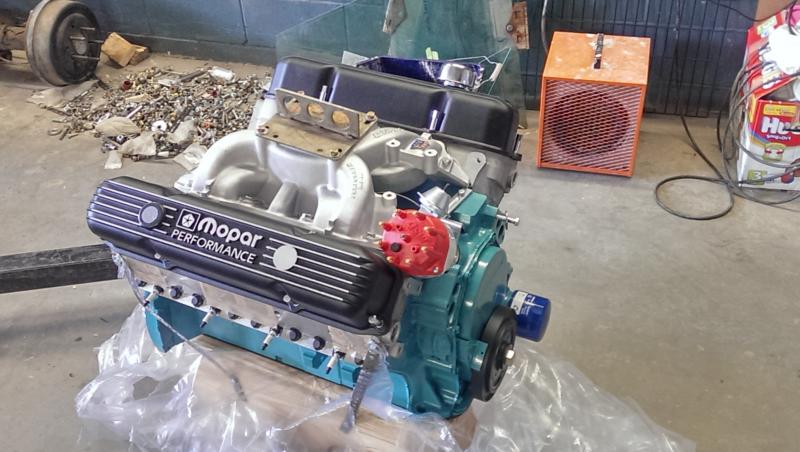

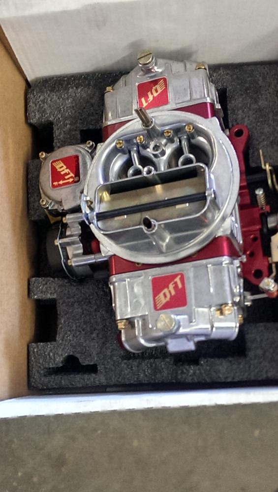

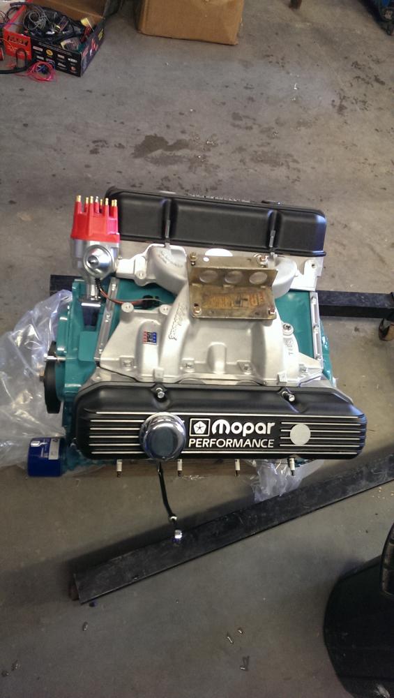

Just got back from the shop and my first look after taking delivery of my new engine from CME
Really happy with how CME packaged all the components in their original packaging separately for shipping (Quickfuel Carb, MSD Ignition, Plug wires, etc..)
I was on the fence about the motor being turquoise (after all my car is in fact a 68) or paint it orange.... CME even threw a couple cans of Mopar Orange in the crate because I mentioned I might lean that way but after seeing it I'm loving it as is.

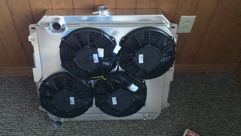

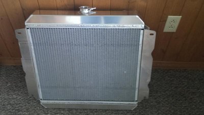

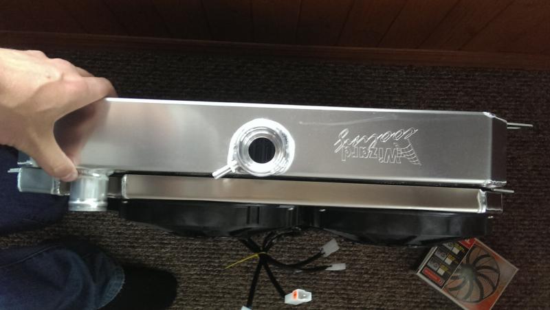

Here's a few pics of the Wizard Cooling radiator responsible for cooling the new engine it's a 22" with upgraded cores and the 4 - 9" SPAL integrated shroud package
Here's my review thread on dealings with Wizard http://www.forbbodiesonly.com/mopar...oling-Package-Arrived-Review&highlight=wizard

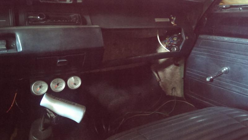

Snapped a quick pic inside of the addition of the guage tri-pack (volt, oil, temp) Autometer Ultralite gauges. Managed to drill a couple different holes in the mounting plate to screw it into the stock ashtray screw locations and prevent making any new holes under the dash. You can also see the new fuse box location again and the jute pad installed behind dash to that point.

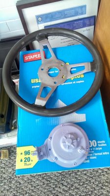

and last but not least my evening project.... The TUFF wheel in the car is green so I'm going to give it a shot tonight with the SEM Color Coat and go black as well as try and clean it up with some Autosol.

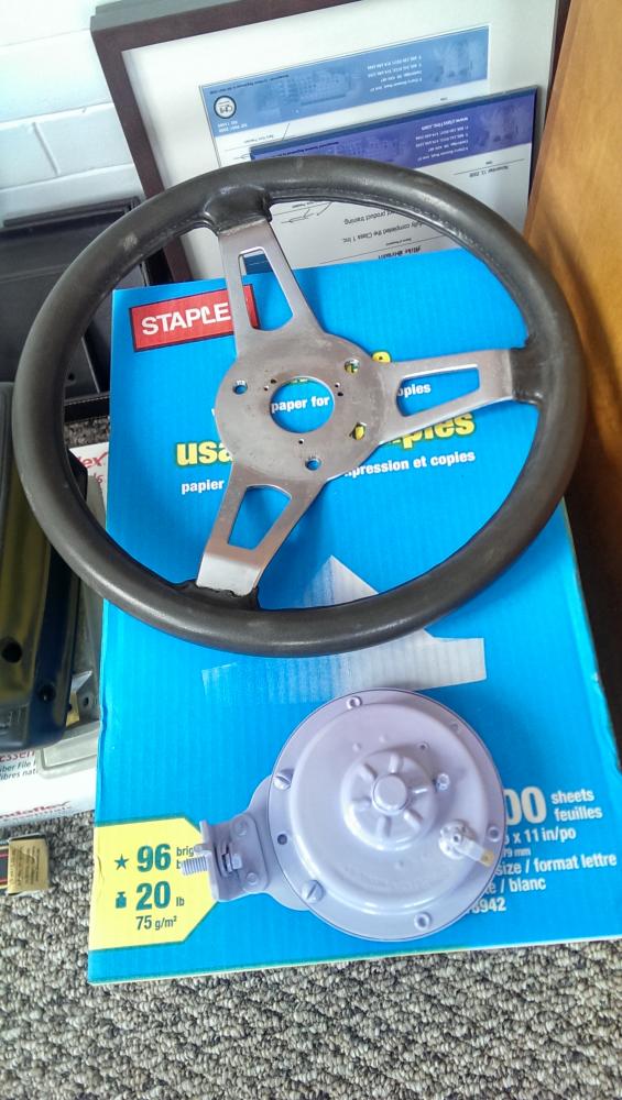

Beside it you can see the re-painted horn.
