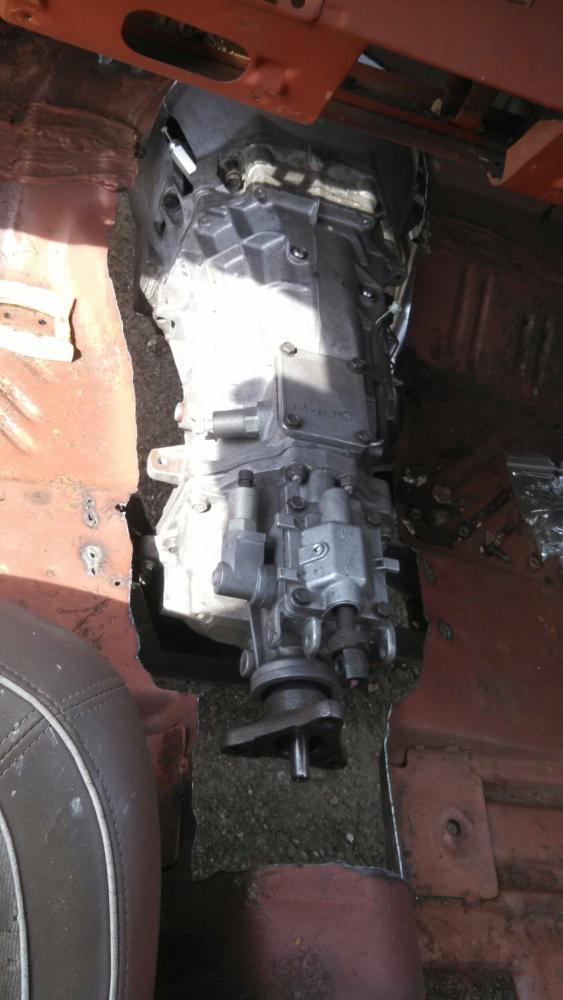

Hey GOON - while we're talking "shifting" to a 6 speed . . . I've gone a slightly different route and picked up a salvaged TR-6060 out of a 2012 Dodge Challenger to put into my car. The advantage that goes with it ( for my car ) is that it as already built to be bolted to the 5.7L Hemi engine . . . so now it's time for me to get to work and modify my hump to make it fit !
My initial thoughts for going with the 5-speed Tremec was that the hump did not need to be modified ( and my welding skills were very thin ) but I always wanted the 6 speed in my car - fast forward a year, and a LOT of welding experience under my belt . . . so now I'll be selling the 5-speed and the 6-speed is already sitting in my garage ! !
Not sure "what" I'll use for a shifter - yet - as I've got to get it in my car ( and my seats ) and find out where everything is going to end up . . .
( but I like the pistol grip shifter ).

I plan on selling the Tremec 5 speed ( work was done to it so it doesn't require tunnel mods to install - complete kit )
Very simple story - always wanted a 6 speed, but was afraid of the tunnel mods . . . not anymore, so I got my dream, a 6 speed, and I'll get it in the car ! !
To fit to a big block . . . probably just need a different bell housing . . .
