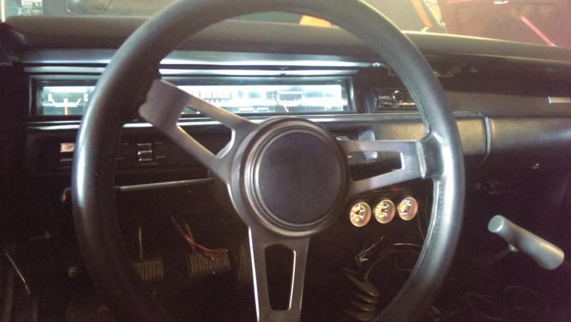

Here's the new callouts in place as well as a pic of the guages lit up in the car.
View attachment 183343View attachment 183344

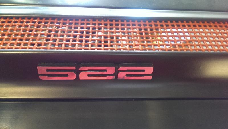

I love this bird.....are the air grabber grilles(screen) available????
Thanks 68Post! I did a quick search online just now (typed in roadrunner airgrabber screens) and a few sites came up that are selling just the screens if that's what you're looking for. Typically they were painted Red but mine were faded and worked so we hit them with the extra can of Mopar Orange Engine Paint that came with my motor so that's why mine look a bit brighter. The A/G assembly I have is busted so it hasn't been on the car since I have owned it

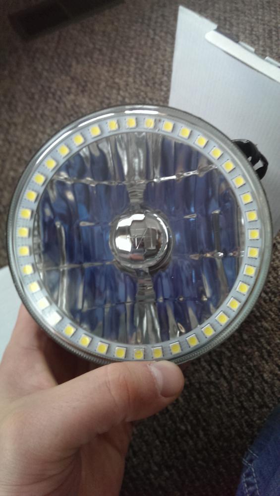

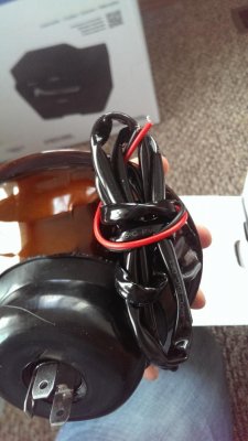

Really liked the look and concept of these lights from a thread posted by WIJNS07 and ordered some for myself since my car is the same sort of Pro-Touring/Restomod style concept. http://www.forbbodiesonly.com/moparforum/showthread.php?79285-Illumination

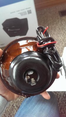

So they arrived this week and it looks like there's some different wiring configurations.
I'm thinking if the LED Halo's are on their own switch you could have 5 possible lighting configurations: Halo Only/Halo Parking Light/ Parking Light only/Halogen Only/ Halogen with Halo?? Does this sound right?
I definitely don't want to wire the Halo in as Daytime running lights because I like the idea of being able to go completely black (midnight cowboy driving we like to call it!) and I don't want them wired in with the parking lights because I always think a Mopar should be able to cruise with Amper park lights only
Another aspect that I really like (for those that don't like the look of something like this) Is that they are just a plug & play Halogen so if I choose to run these for a season or 2 I can easily unload them and go back to my regular halogens if I so choose.
Here's some pics of what showed up.
Those should look pretty awesome on there but I would think the right way to wire them would be to tie the Halo's into your running lights? Should look great!
You are the 2nd person to give that opinion from 2 people's opinions that I hold in high value! Noted! :)
(plus that still allows me midnight cowboy time! bahahaha

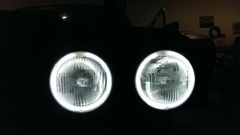

Didn't realize you had the same one's Wookie!! Damn that looks sharp! Looks like Halo wired with parking lights is a winner!
How do you find them compared to regular halogen lighting when fully on at night?

I have the RGB halos. I can make them any color I want. The module has many modes you can play as well as programmable. Cop mode is cool.
H4 bulbs kill stock headlight. Be sure to beef up the stock headlight wiring though. I think there is a thread or 2 here somewhere on how to do it?

Whole car was re-wired last year beefed up already to support my current Halogens with relays so I should be alright. The programmable aspect of yours sounds way cooler!

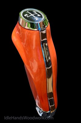

I've been thinking a lot about ideas for the shifter that will be custom made for the T56 going in my car
I have a top notch fab guy that will be custom milling me my shifter handle and I wanted the grip to be milled based on the classic mopar pistol grip. Since the shifter will be in a different location and I run a Bench seat I need to do a "One of" It will be milled stainless with a custom scribed 6 speed pattern on top
I'm looking at a set of these grips in either Hemi Orange Dyed Figured Maple or Hemi Orange Dyed Tiger Maple to finish off the custom look from http://www.idlehandswoodwork.com/index.html

As for the shifter handles I emailed the owner of idle hands Nick Tambakis this morning and have already gotten 2 replies answering all my questions. I was NOT expecting to hear back on a Sunday and this guy sounds like a skilled craftsman and super nice guy!
We think to much alike, I borrowed a plastic handle off a buddy to copy the old Mopar grip in Curly Maple just like you pictured.
I thought you were just going to modify the grip your father already milled but the Curly Maple will tie in all the rest of the work you've already put into the console and dash beautifully! When I saw these I kinda thought to myself (Dev would just see this and make it himself just as nice! hahaha!)

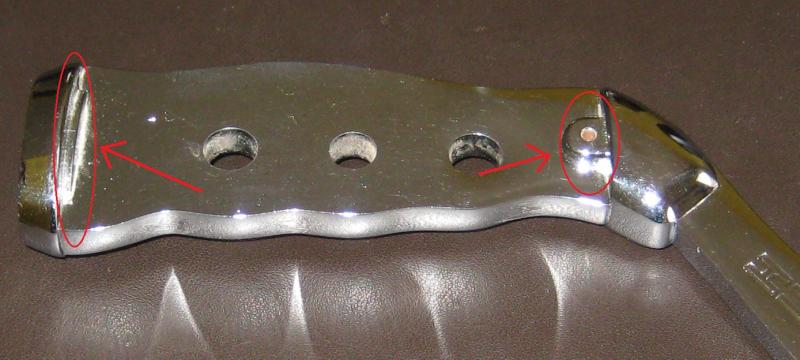

I'm sure you know this but one piece of advice I was given for the shifter handle was there are metal "tabs" at the top and bottom that help to keep the grips from moving once installed (see attached).
