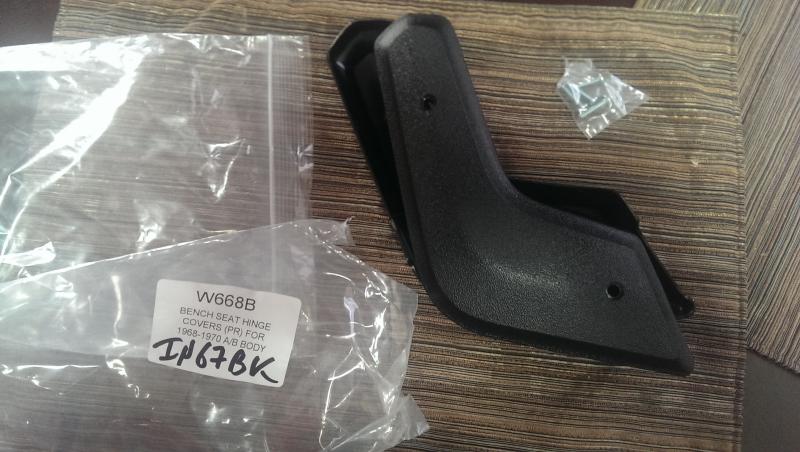

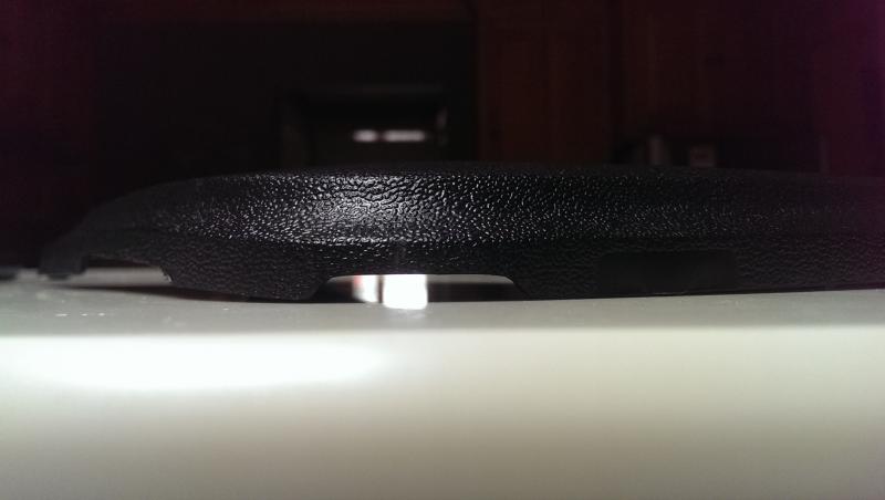

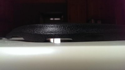

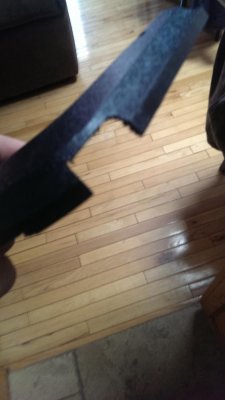

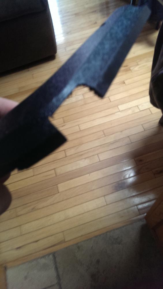

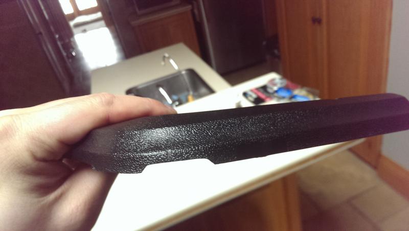

When my seat was out go get re-foamed the guy doing the work mentioned I was missing the plastic hinge covers for the side of the bench (I wasn't missing them I never knew they existed! lol) So when I got looking at some pics online and saw that it does provide a cleaner look with the door open then just seeing the hinge I ordered some up from National Moparts. a simple 2 screw installation meant the seat coming back out so I could get to both screw holes which was a blessing in disguise because I wanted the push clips on the hinge retainer better than they were anyways (mission accomplished.. I had started another thread wondering why I was having such a hard time... one of the push clips had snapped... duh!)
What disappointed me slightly was how much I had to carve out of these new replacement plastic covers with a dremel to get them to clear the back pin where the seat latch secures too. These pics don't even do justice since once installed I had to keep cutting back to the edge of the bezel.... these weren't what I would call cheap ($65 CAD for the pair) so a bit unimpressed.
Update I got a reply from Nigel at National Moparts and he agreed there are some issues
Hi Mike
Thanks for the Feedback.I compared the "high quality" repros to some used originals and they definetly have problems.They appear to be too shallow overall as well as having
insufficient cutouts for the seat back release knobs.The tooling for these was originally made by Kent Quirey of QQE.He retired two years ago ,sold his company to a Mopar guy
that I know.I'll forward your pics as well as some research I have done and see of they can redo the tooling.Hard to say if they will though what with the economy and sluggish
state of the old car hobby.
Questions:
Was the upper screw hole in the correct location ?
If you still have your used originals could you please give me the #'s off the backside ? There should be a 7 digit part # starting with a 2 as well as a 4 digit #.
Thanks For the interest.
Nigel
National Moparts

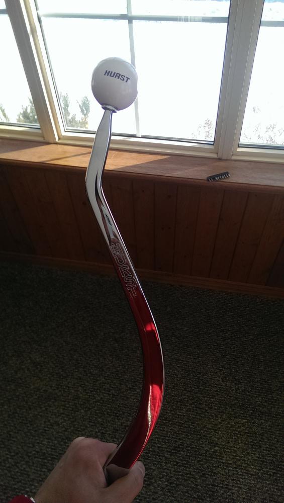

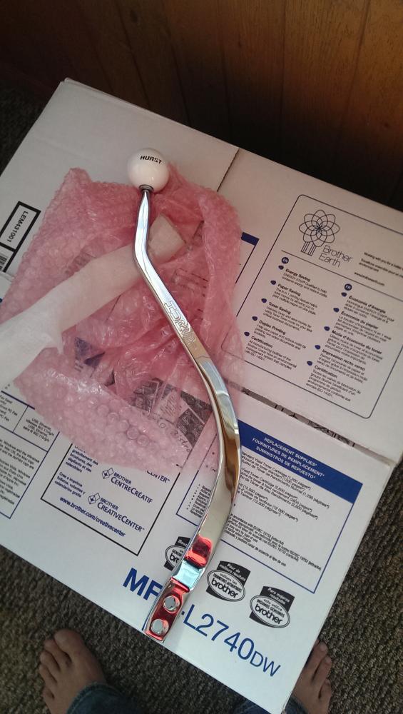

So as posted above before I made the move on the T-56 with Devin I was looking to change the shifter on my 4 speed. This arrived today so I guess I'll have a little something different in the car for the time being and will be able to sell 2 shifter handles when I sell my A833. newshifter.jpgView attachment 231662newshifter2.jpg

That new shifter handle for the 833 is awesome, but I'm seriously looking forward to the 6 speed action haha

I found these re-pop pistol grips that you can order with 5 or 6 speed script that I would love but I'll see what decision I end up making there later down the line.
http://www.proformancepowertrain.com/mopar/transmissions/shift_handle.html
A pistolgrip would be bitchin but it's all up to what feels best for ya. Were the bellhousings Devin found being sold by a store where I could get one for the same price? Or just individuals you were lucky to spot? Haha
