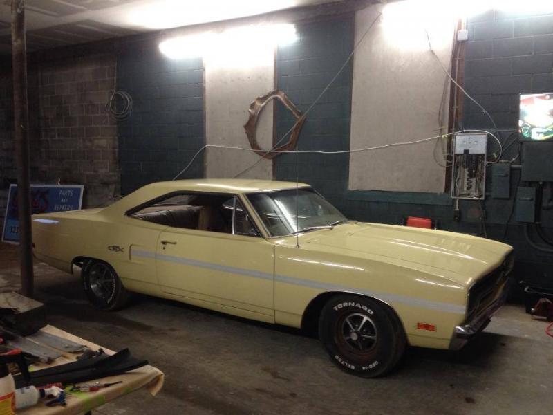

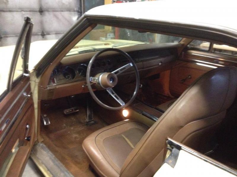

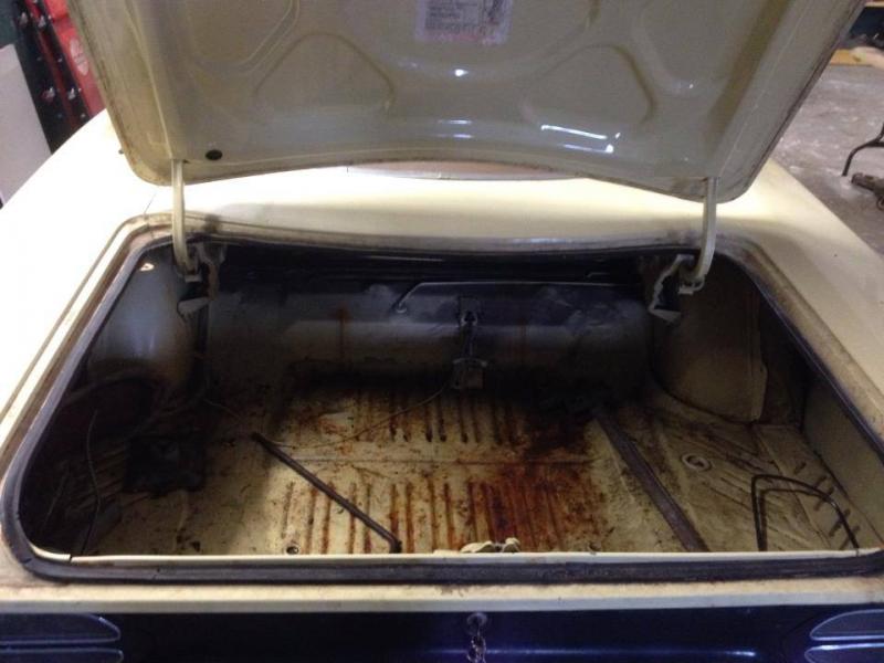

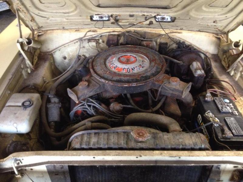

Thought I would share these pics with you guys.... When I dropped my car off at the shop last fall the owner said his buddy had just got ahold of a 70 Charger Barnfind and there was a 70 GTX next to it that he was going to look at... I guess the old man had passed and his wife was downsizing and unloading the cars... He picked up the GTX as a flip but decided to advertise it as a project and couldn't believe how much action the car got and sold immediately... here's what he brought home

Glad you like the pics of the Barn Find Patrick and I'm sure you'll be fighting with yourself to pick that colour right till the end but I'm sure whatever you go with will look sweet!

That is one nice GTX he picked up and will make for another great project, Your short video makes a smile the way it sounds and it gos good with your L-plate, The angry bird sounds a bit angry man!!! :)
I agree Ron it will make someone a great project I'd love to follow that restoration for sure! I looked at it briefly when it was in the shop and the hamster wheel started turning with a few ideas about picking it up myself for a future project but I knew it would be a stretch to get the $$ together and then have to sit on it for a long time before it could be brought back as a survivor or a correct restoration.
Glad the video made you smile it sure brought a grin to my face too and I'm thinkin' the same thing... Angrybird will be true to it's name! hahaha :)

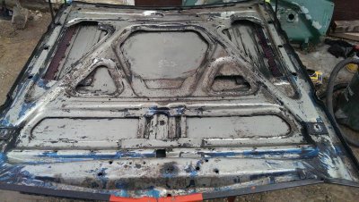

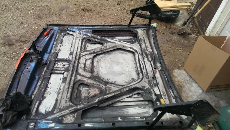

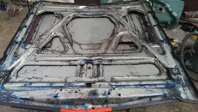

I also put in some time trying to de-grease and scrape several layers of color, stickers and grime from the underside of my hood so it can also be cleaned up and painted.
So here's where I'm at. Once the new mounts get here and are installed we can plumb the new exhaust. I just caved and ordered Dynomax Ultra Flo's because I didn't want to use the Flowmaster Super 40's that came with my kit and figured I may as well get the one's I want now and sell the Flowmasters new and untouched.
I think I got the guage cup sorted for the tach I was having problems mounting and should be picking that up from the local Performance Improvements store today where I also ordered my K&N Xstream air filter last week.
Once this exhaust is plumbed we can get this thing warmed up and dial in the carb and timing and rubber should be ready to hit the road.
Here's a pic of the after of the hood (found orange, black, blue, green and silver) as well as something else that finally showed up that put a huge smile on my face
