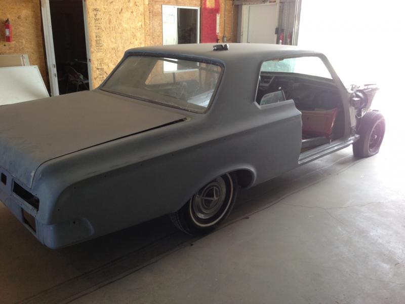

What would be a fair price, or what did it cost you. to do this work. Professionals opinions too please.
!964 Dodge 440 All body work done, all trim removed and primerd with plenty of epoxy primer
Cost to:
Block sand , maybe do a few places with spot putty
Probably primer again and final block sand
Paint with Urathane single stage color --8 coats
All material paid for and not included in cost.
Wet sand
buff
clean buff residue.
I would like to get a lot of feedback please. I will explain later..Thanks..............................MO

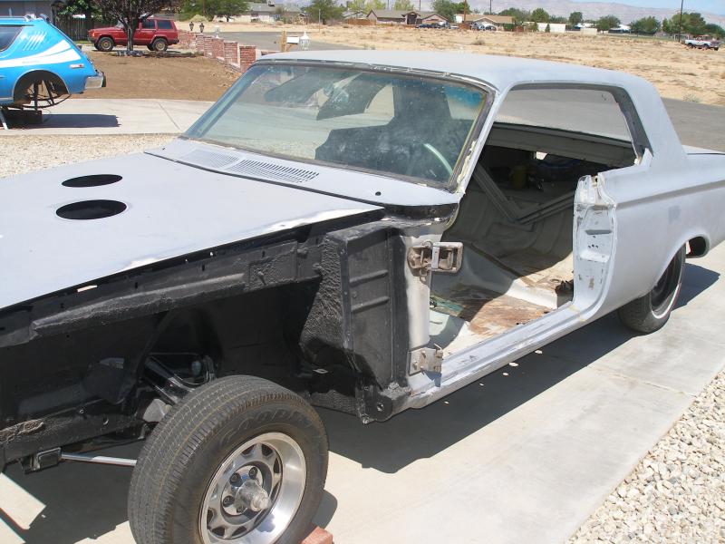

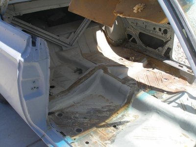

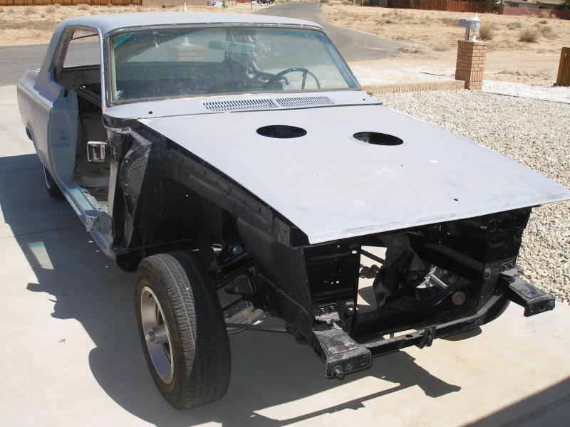

I paid $5,300 for this and I threw in $1,200 for the paint, hardner & clear coat. 4 1/2 years later I pulled it out of shop and I'm prepping for filing it in small claims court
