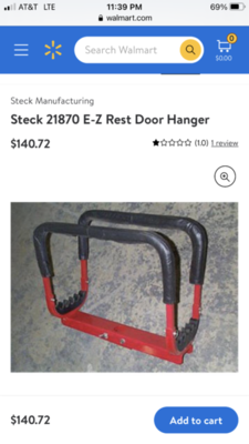

If you don’t want to spend the $100 for a one-time use tool, consider the home made version, lol. Screw some arms to a 2x6 and screw it to the jack saddle. Worked well enough to get me two doors back on.
