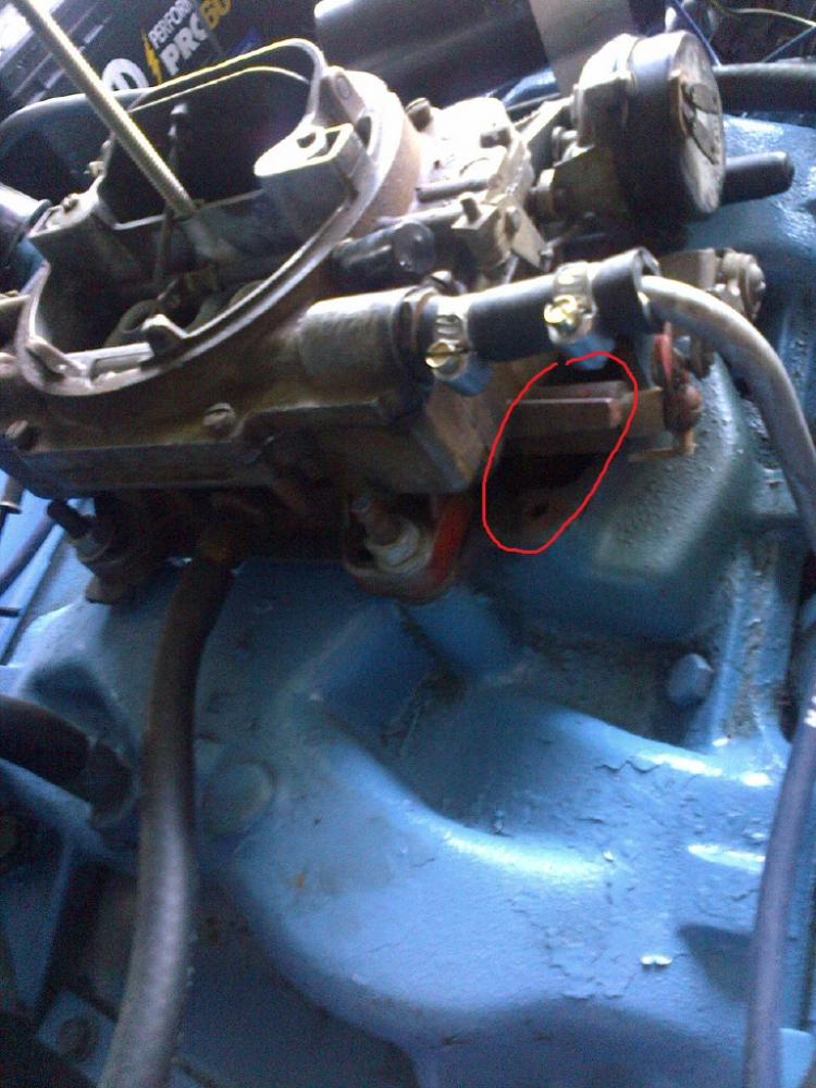

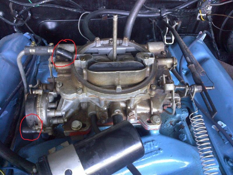

I started to pull a couple things off and I am no mechanic by any means however, I noticed some pretty unusual things. These photo's below are posted from a center shot of the carb,side stepping around the passenger side and a slight picture from behind the left side of the carb.
In the previous thread I had described a gas leak as well as a vaccuum leak at idle which is less than 5. (this is still happening)
In the first picture I notice two problems highlighted in red. The circled red object at the top of the picture was an attempt by someone to seal a port into the carb. They used silicone and some kind of rubber cap and it definitely did not seal the port. The second red circle near the electronic choke has the same thing - silicone with red cap.

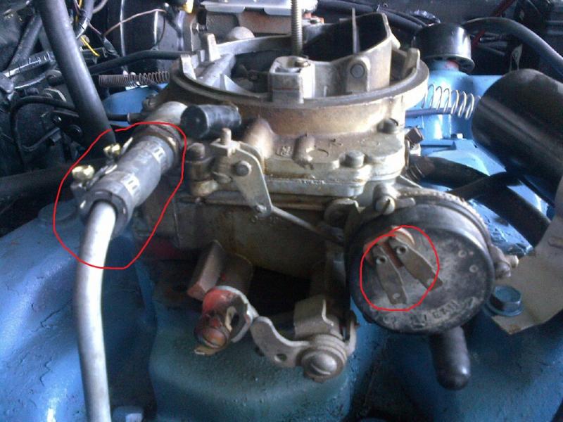

The second is a shot of the carb from the passenger side. There is an electric choke with no wires going anywhere to it. I only drive it in the summer and wouldn't need it but it still looks unusual. The rubber hose with the garden hose clamps - this looks completely sloppy and not even sure if that is legal?

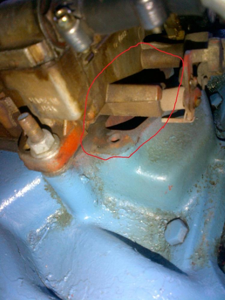

The third and fourth pictures indicate my final conclusion that this is not the right carburetor for my 440 - why is there a gap into my intake? It looks as if this carb is too short and doesn't fit the span of the intake at all.

Looks like the pictures reversed themselves. As described in first post - Picture 1 uploaded as picture 4.
The pictures reversed themselves. In my description to picture 1 is shows up last. I am sure you guys/women will catch on.

it's an aftermarket afb. carter made some of these carbs with a chrysler throttle arm and thats what you have. reddish/orange stuff looks like engine paint overspray. look for a number at the front passenger side carb to manifold bolt. if there's a number there you can look it up to see what it is.

Alrighty.. I'm gonna throw a few cents into the pot and address a few of your concerns...
1.) The hole in picture 1 is the choke well, I'd recommend buying a block off plate
2.) the electric choke - looks like it's rigged to be open at all times, if you aren't worried about it, I'm not worried about it
3.) the hose and clamps deal - heh.. yeah it's legal, and you see it a LOT.. if it makes you sleep better at night you can put a longer piece of fuel hose on there and put a couple clamps
Lew,he has the number is listed,9501S.I know,I'm old too !!
9501S is an aftermarket 500 CFM carburetor with a Mopar linkage set-up. It is not original for your 440 or any other car. Personally I think you would be better off buying a new Edelbrock 600 CFM (#1406) or a 750 CFM (#1411) depending on your intended useage. The problem with old carburetors is that you never know what guys have done to them. Starting with a new one you have a great set of instructions and a great tuning guide. As has been said, you can buy a block-off kit for the choke well, and a replacement fuel line to the carb. I'm still curious as to why there is only 5" of vacuum. Did you try spraying some water at the base of the carburetor (before the motor gets hot) to see if it changes the idle? All the vacuum hoses and fittings need to be inspected as well. Initial timing could also be way off. Good luck and hang in there.

the 5 pounds of vac at idle is still you major problem.try slowly covering the top of the carb with your hand while its running.if it smoothes out and dosnt stall when you get it covered all the way,then you have a vac leak.finding it is the next issue.do what dave said and put some water into a spray bottle.hit the base of the carb and all along the edges of the intake manifold where it bolts to the head.wnem you hit the bad spot it will try to stall or smooth out,could do either.that carb looks very old and could have an internal leak as well.
