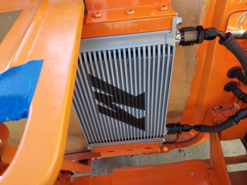

Just finished up on the transmission cooler install.
Looks nice! Can’t tell exactly where it’s mounted tho. I was thinking of putting one under my battery tray. With a fan on it of course.
Very nice. Uh, we need some background information though. What transmission? Are you doing a swap of some kind?

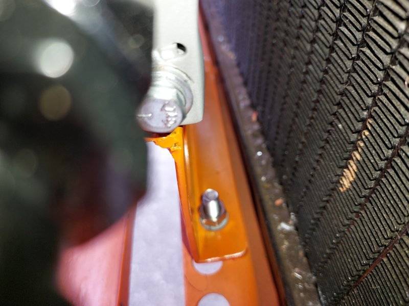

Hard to really tell how you mounted it I’d like to repop those brackets if you could take a better picture please
Hard to really tell how you mounted it I’d like to repopulate those brackets if you could take a better picture please
The brackets are 1 1/2" x 3/4" aluminum and the top piece is 1 1/2" bent that's for the top bracket up 3" then bent to 1". I drilled and tapped 5/16×24
Are you going through the radiator first, and then through the cooler like the factory did?
What is the brand of the cooler? I see an “M”, or is that a W? Looks like a well thought out installation. Thanks.

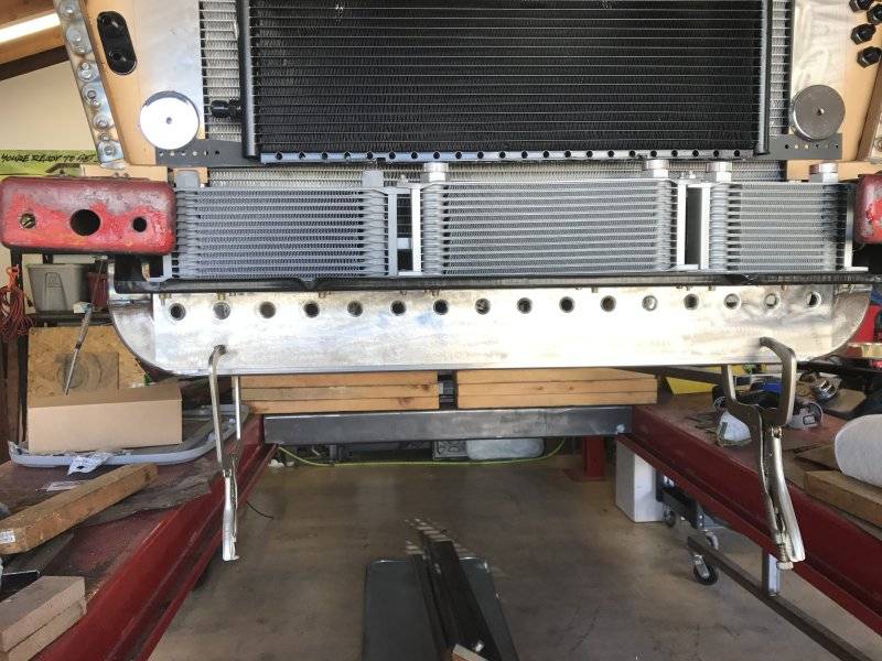

Nice. That is the same style of cooler I'm using for my 65 but x3. Trans, engine, p/s. They are very efficient. I think its Mocal or Setrab that makes them. Got my units from Earls.
