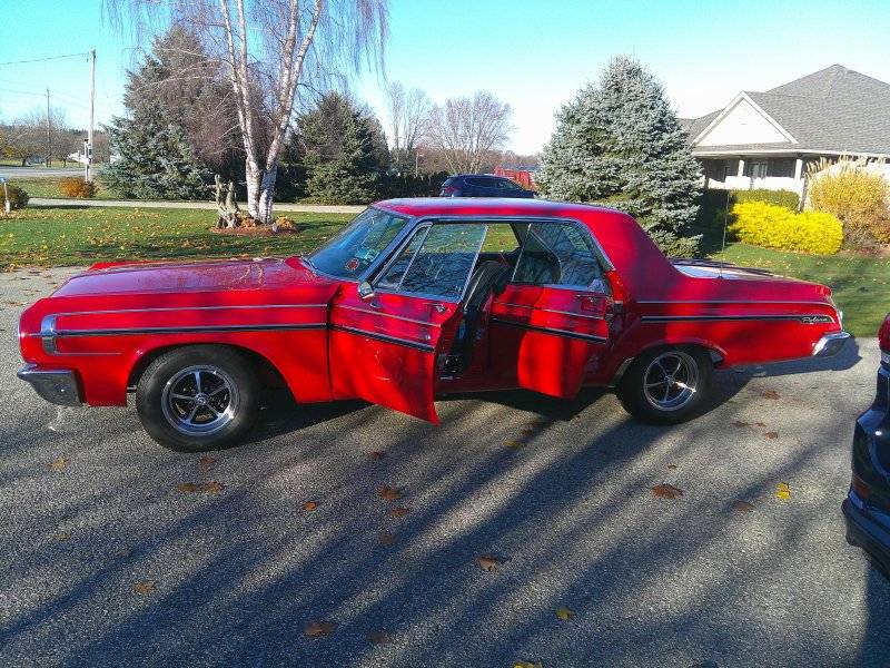

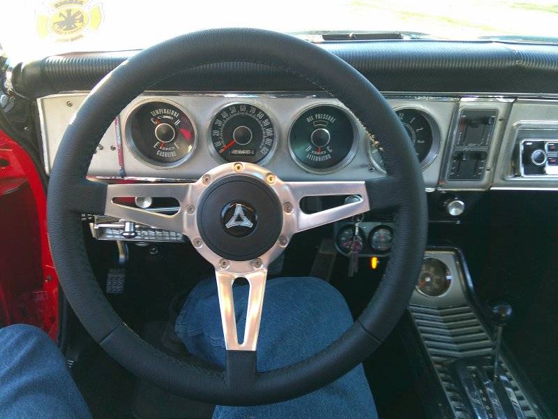

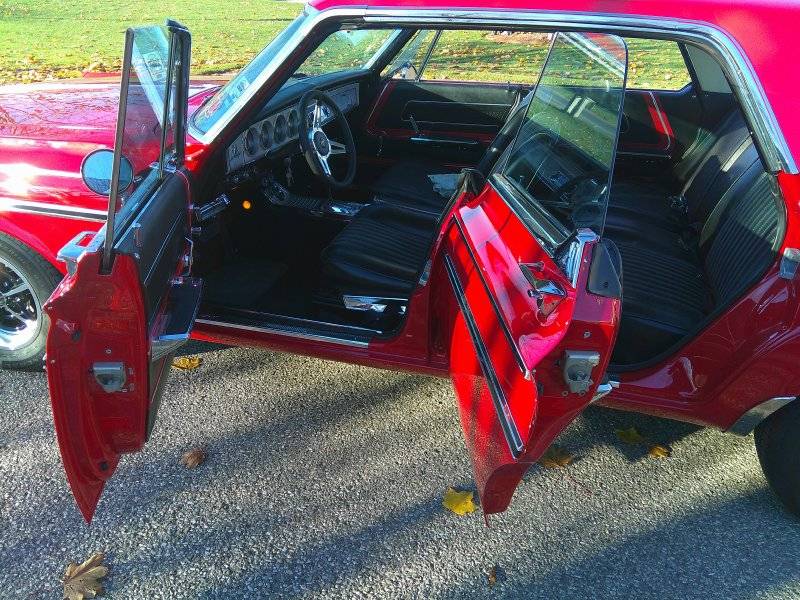

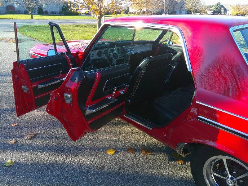

I could not get a video to load, so here are some pictures instead.
Thanks for the interest shown in my '64 Polara, guys (and gal). I really appreciate it. It has been a long haul. I haven't figured out the video thing yet. Please stay tuned. LOL

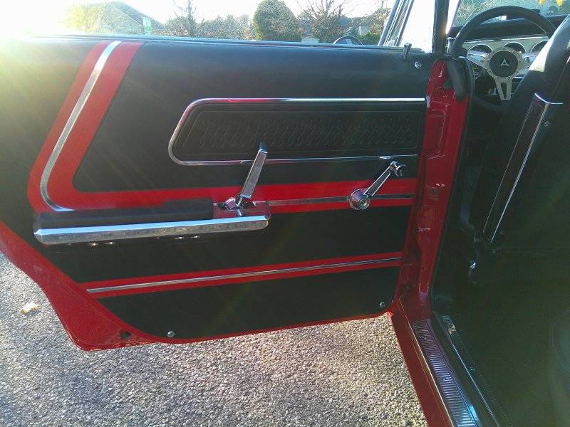

That interior is really sharp Dave. Are the red inserts factory?
Hi Dave. No they are not. I once had a U.S. Polara 4-door hardtop parts car. It had factory air and tinted glass, which I put on my Polara years ago. The factory air never really worked right, so I have replaced it with Vintage Air. This parts car had a red interior that was much more ornate than the Canadian interior. I used the fancier U.S. door panels by masking some of the red areas near the chrome accents, and dying the rest black, to bring some of the exterior colour inside. I have had nothing but positive comments on this feature. I also used the longer front door armrests on the rear doors. They bolted right on. The U.S.parts car also had much more interior chrome that I have used as well. Thanks for noticing.
Beautiful! It’s so kool to see a 4 door hardtop B Body! GM made intermediates up until ‘72 if I’m not mistaken.
