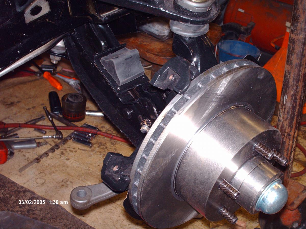

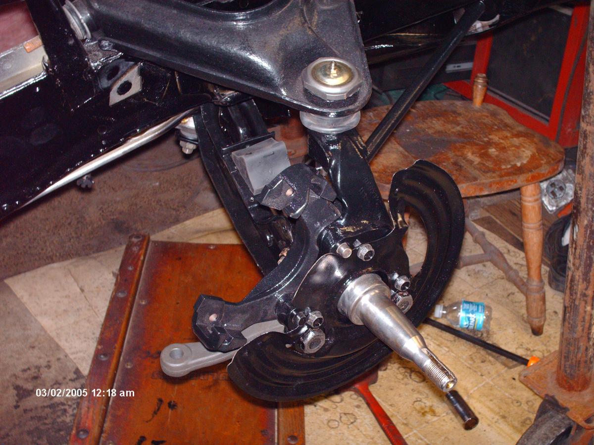

I would use parts off a diplomat or similar car , I converted with a 73 charger spindles,rotors/bearingsand caliper bracket,72 challanger calipers and pads the only problem with that is I have to mount the calipers on the back of the spindle so it doesnt hit the sway bar and am having a had time finding a brake line to work. if you mount them on the front with out a sway bar you can use 72 challanger hoses. hope this helps and by the way I have a 69 road runner

My 72 Charger is currently running spindles from a 75 Dart with brakes from a 78 Cordoba (10.87 inch rotors with slider style calipers) but I'm about to switch to 11.75 inch rotors (Mopar - late 70's police brake size) with Wilwood calipers.
my 67 clone is running with the disck brakes off of an 87 new yorker. very common to find in junkyards and it puts the caliper and hose in the right spot.
