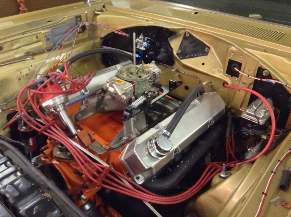

Hey guys,
Finally wrapping up this project as I see the racing season fly by me... Curious on what you guys think it'll run... Hoping to start it up next weekend as I get the rest of the car wired back up!
505 CID
264 IN/274 EX DUR @ .050
.620 IN/.643 EX - Solid Flat Tappet
Installed @ 108 CL
Stock (Ya I know...) 452 Iron's
11-1 compression ratio
5200 stall 9" Converter
Single Plane TM7
750 Carb (Under carbed, but its what I got for now...)
Running 4.11's out back.
Car weighs 3700.
Any advice or thoughts with first time start would also be appreciated!
View attachment 346932 View attachment 346933 View attachment 346935 View attachment 346934
That thing rocks , I bet it's a blast to drive .
I'll be interested to see what you run with your 505.
I also built a 505 but it's also on hold while I wait for the Victor heads to get back from porting.
For my combination I'm looking to see some 10.5 time slips, and anything quicker than that will be bonus.

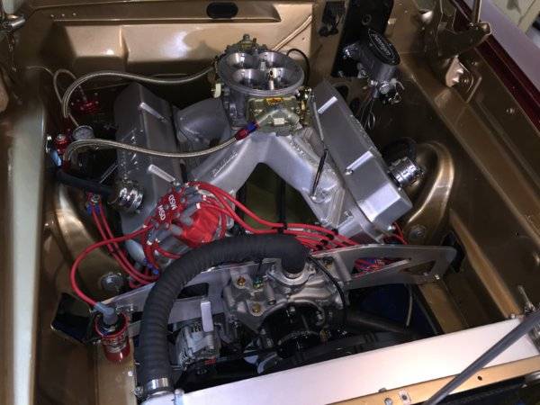

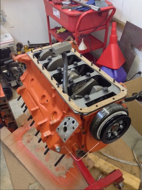

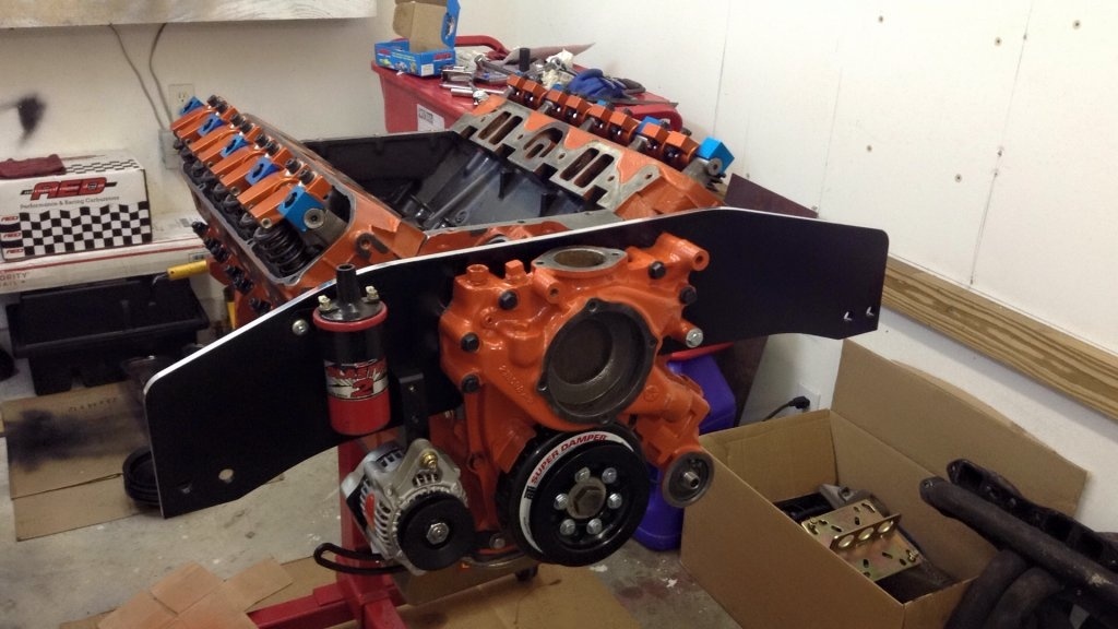

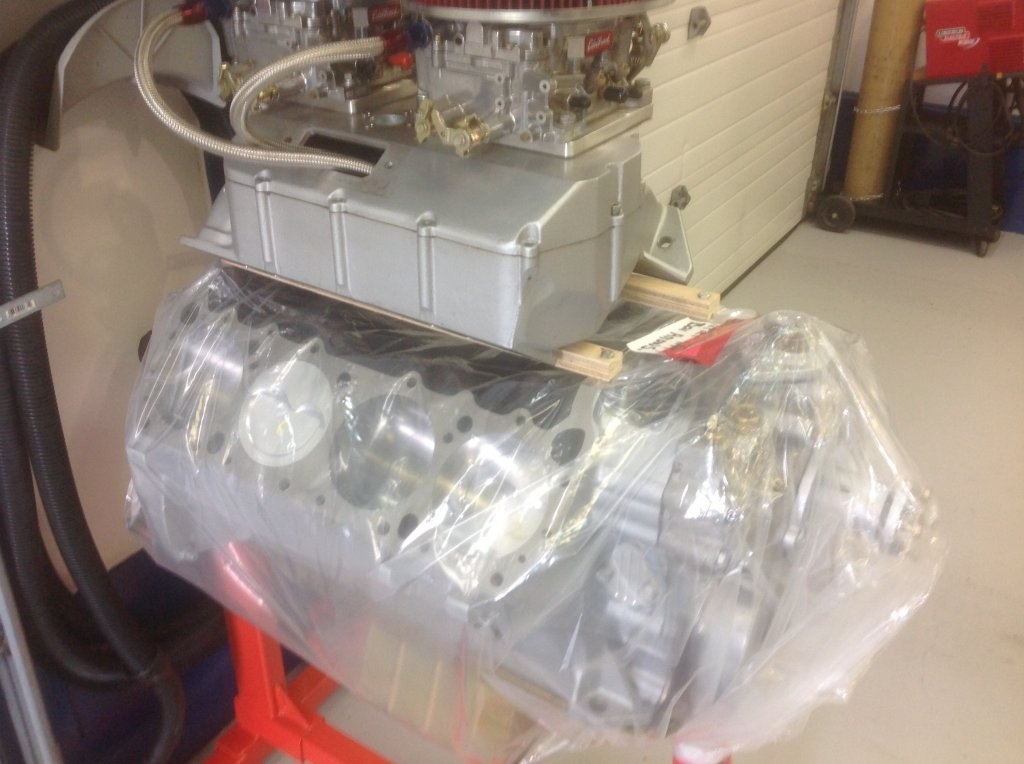

The combo I've put together is also a 505 but with:
Edelbrock Victor Max Wedge heads - full port, will have before and after flow numbers when done
12.7 CR
274 / 282 @ 050, 672 lift solid roller
Indy Cross Ram with 750 Eddies.
Dynamic 5000 converter
Pro Trans with brake
Dana 4.10
3400 lbs less driver.

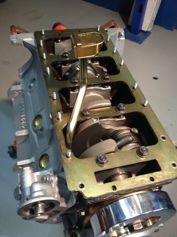

I also went with the ultra light crank, aluminum main caps, stud and girdle to help hold it together.

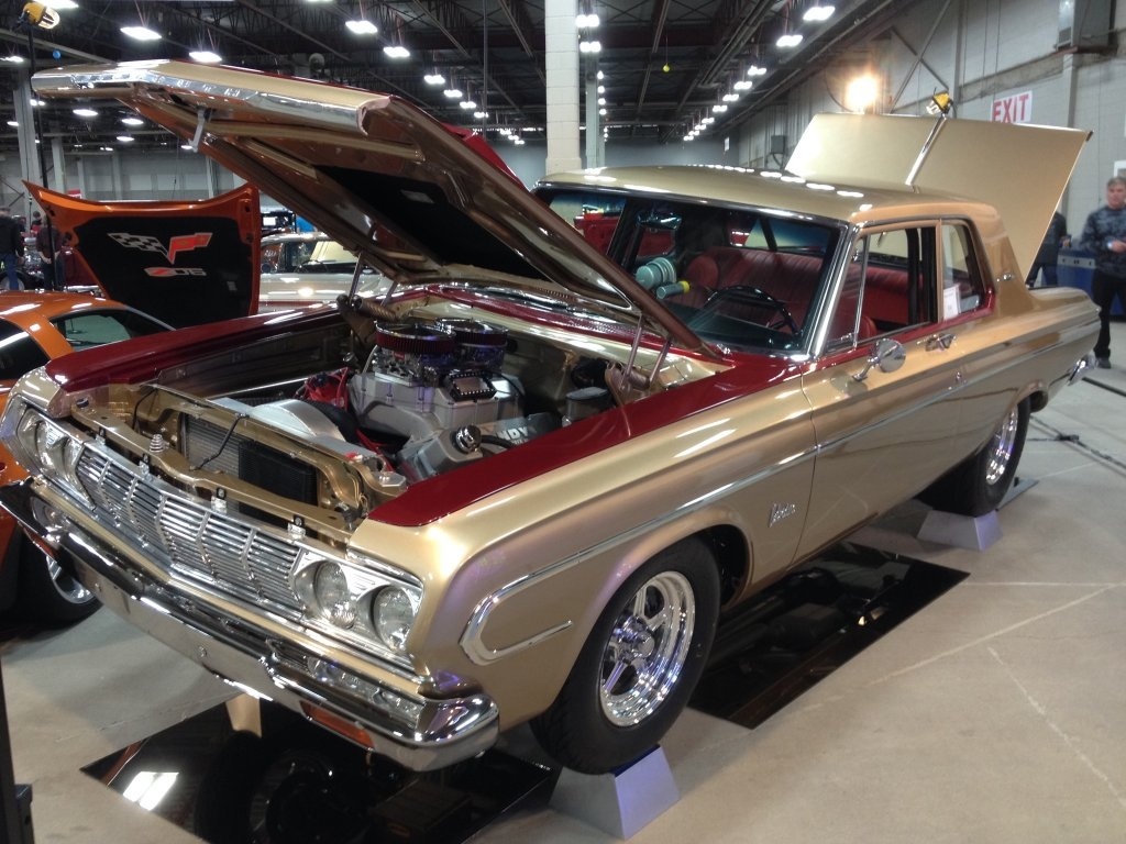

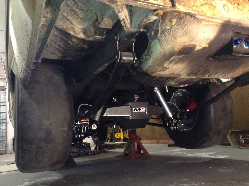

Check it out.

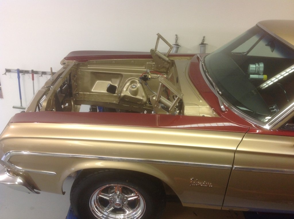

The last picture was taken before engine removal a few months ago.

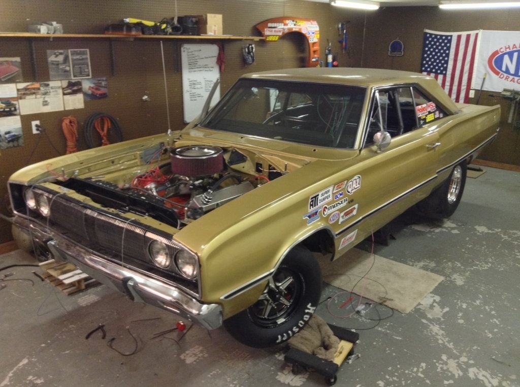

A year later. And Mr. Mike Gaines was right about having a 10.30 motor.
