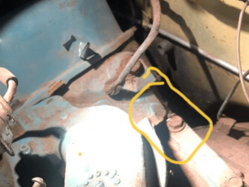

I can see you have a B engine block, 361, 383, 400 by how close the end rail bolt is to the intake. A 440 is wider than that and will have the end rail extended past the bolt.

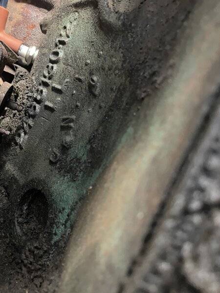

So this is on the driver side. 246813012. Google say this is a 383.
There should be a pad in front on the block that will say 440. Also, if that is a #'s car, the VIN should tell you what kind of engine is in it as well as the fender tag if it has one. I've had fuel leaks and it will make the car run crappy. Where's the leak coming from? You need to fix it because that and that plastic fuel filter are a fire hazard. I'm definitely no expert, but have had similar problems. Vacuum leaks will cause it to run lousy too. Make sure the carb bolts are snug. Original gas tanks can have crud in them that restricts fuel and can really F things up in your carb. Definitely check the plugs.
The vin decoder says it's a 383. The previous owner swears it's the original engine.
So what you have is a 383 w a 75-76 400 thermoquad intake. Even if that carb is from a 4.3 GM V6, if it is tuned properly, will have excellent off the line w an automatic. So if it's a dog, the many above suggestions should be tried from least invasive to most.
