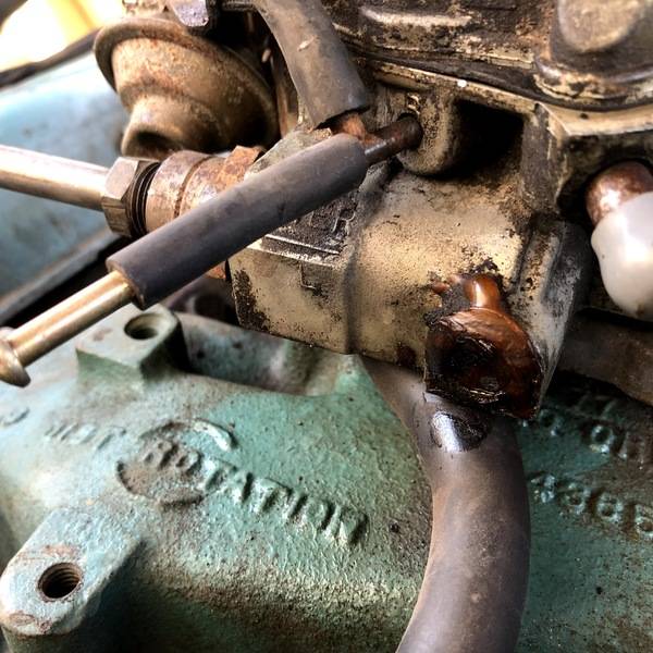

                This is where the leak was. I think the PO epoxied this just before selling the car and didn't clean it. It was much worse when I got it, but I cleaned it up a week ago and it's almost dry.
                The fuel inlet says FILTER with an arrow. Is the paper filter supposed to be in there?
                LFn469p1v3WKFfp1uhJJ8Mqaez4ySwLCdaRjcWfZZtLW0nelwSarBnBLcnunJCTYTrn4QfGlDqIw=s1896-no?authuser=1.jpg
              • Don Frelier
                Don Frelier FBBO Gold Member FBBO Gold Member
                Messages:
                4,498
                Likes Received:
                5390
                Joined:
                Oct 11, 2016
                Location:
                Ionia, NY
                Local Time:
                3:57 PM
                One dead cylinder is about a 25% power loss.
                That needs to be top priority.
                I wouldn't spend any time on that carbeurator.

                  Yep that would be where it is if someone hasn't already removed it. There was a filter and spring in there from the factory. No harm in leaving these out as long as you have the inline filter. Just hoping for your sake it's still there and restricted. The leak issue at the plug someone epoxied isn't uncommon for a Quadrajet. I used to rebuild a lot of these back in the day. Normally taking a small hammer and peening (flattening) the lead around the outside of the plug would fix it but using quick set epoxy was also a common thing. Yes it needs to be clean!
                  • Thanks! Thanks! x 1
