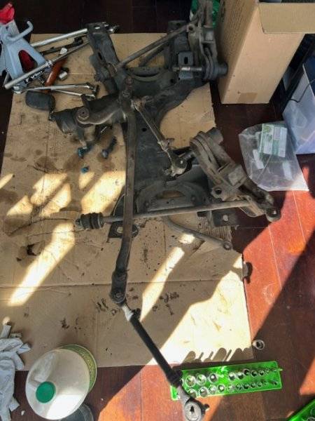

My son (mostly), and I are disassembling the K-Frame and I’m wondering is it best to sand blast the whole thing, or figure out a way to de-grease and clean it up, then paint and replace rubbers, etc…?

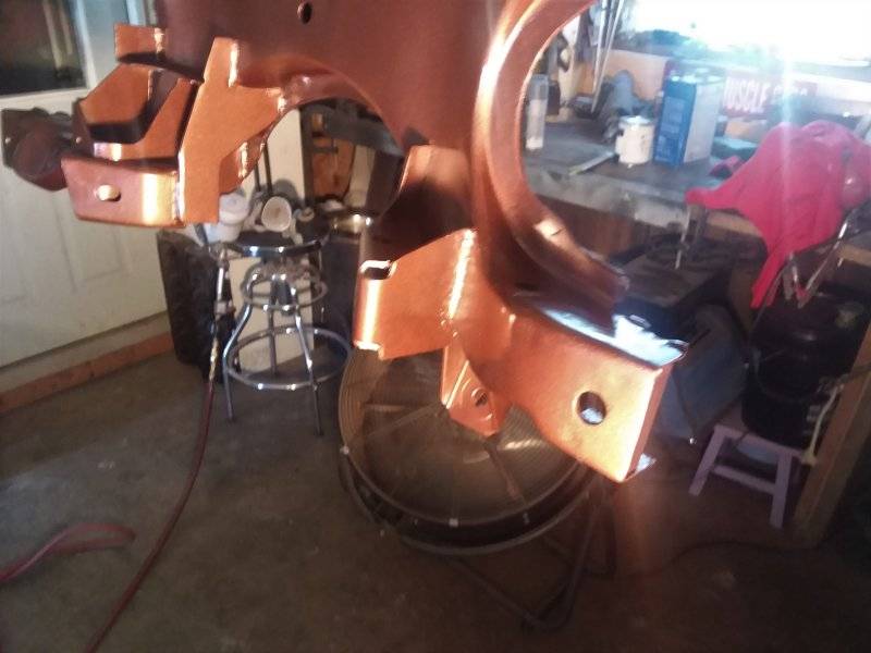

I blasted mine with an Eastwood sand blaster epoxy primer Ed it and then sprayed it with gloss black urethane paint.

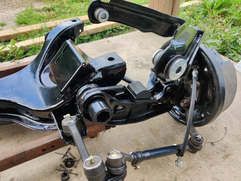

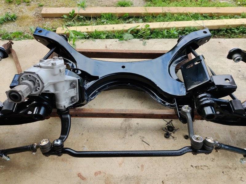

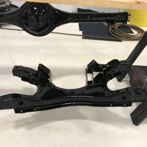

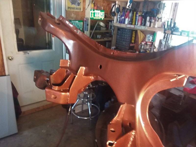

Degreaser, elbow grease and pressure washed it. Sanded by hand, epoxy primer, single stage AU.

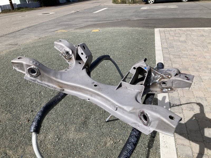

I got mine back from being blasted only yesterday. $30.00 in Atascadero. Wanted it cleaned off so I can do the rest of the work on it. One thing you can do on yours to help cut down some of the cost, get it cleaned of the accumulated grunge. Either take it to get hot tanked/jet cleaned or use elbow grease
