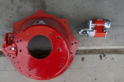

Anyone ever run a Lakewood bellhousing (p/n 15330) with an MSD mini-starter specifically? Or how about a Lakewood bellhousing with ANY mini-starter? Trying to get installation nailed down.

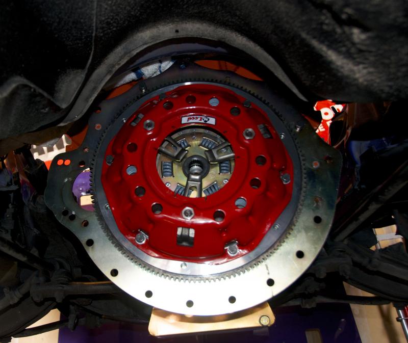

Have brand new scattershield, MSD mini-starter, Billet 132 tooth Mcleod flywheel, clutch, and throwout bearing. Lakewood block plate is on, flywheel & clutch on as well. Now I am down to the 4 configurations (A-D) they list in instructions. None of the configurations lists MSD mini-starter by name, but there are MANY mini-starters also not listed.

Anybody out there have experience with this? If so, I really need help understanding how a mounting point that will accept a big gear reduction starter won't accept a mini-starter with exactly the same attach point, nose is same depth as stock, and all that I really see that is different is the size of the motor.

yes I used the Lakewood with a mini starter.Bolted right on and never any issues....

I have an old Lakewood bell housing with a mini starter (Chrysler) and I had to grind the block to make it fit. It fits the bell housing just fine but interfered with the block. I cut out a section of the block plate so the starter mounting flange was flush to the bell housing. That allowed the nose cone to pilot into the hole in the bell as it should. Flywheel is 143T I believe (10.5" clutch set up). Oh, and that mini starter you have looks the same as the factory MoPar one.

Hey Meep Meep, thank you, that is a good idea to make starter flush. And no, I am running 132 tooth flywheel with 10.5" clutch. Well, I could also install an 11" if I wanted to, have both bolt patterns. And yes, I agree my new MSD starter "looks" like stock Mopar starter, but is not even close to it in size when laid side by side.

I had the Lakewood up on the block. Looks like it will fit pretty easily. At least it looks that way. Seems odd that Accel Performance would own both Lakewood and Quicktime, and one would fit great, and one would not. But I guess just because you are owned by same corp, doesn't mean they share anything between them.

I also run a Lakewood with the mini-starter on my 440 - I think the starter is the Matsushita (Japanese for MoPar)

The other thing I have been trying to find is exactly where do I have to grind the half moon shape out of the passenger side of bellhousing according to TTI? It sure would be nice to do that on the bench before I even attempt to install headers. But that might be a pipe dream, as I imagine the shape and location vary quite a bit. Just wishful thinking..
No grinding on mine - I also run TTI 1-3/4" headers. It's a close fit at the front of the starter (you can get a feeler gauge in there) but it is clear :headbang:
