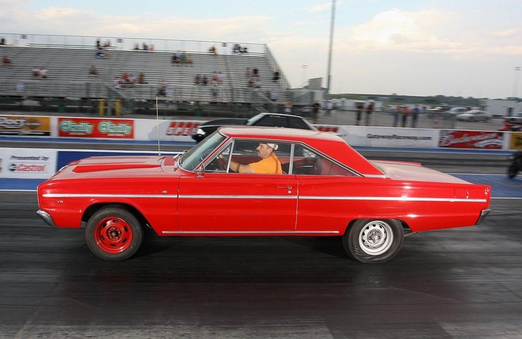

67 Coronet. 3978#, 500" lowdeck, 727, & 3.55's. 11.96 on street tires. With me driving to boot. (I'm not that good yet.)

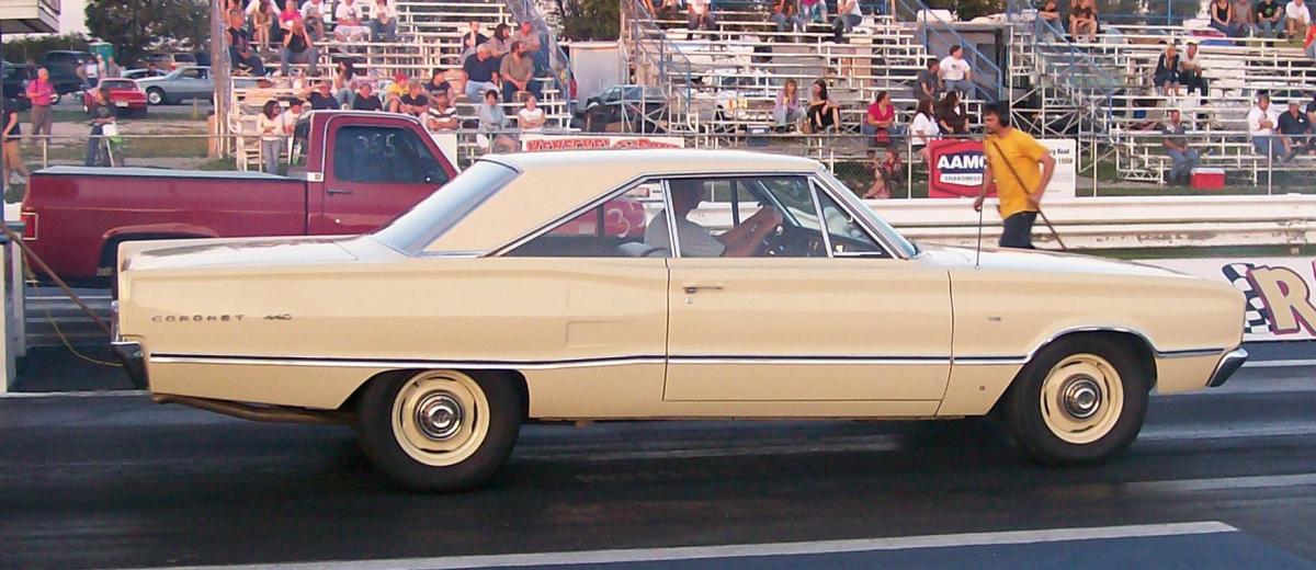

got away with out having to wear a helmet that I left in the trailer. got pulled aside on the next round to make sure I did have an approved helmet. The track guys have no sense of humor.
Now thats what I am talking about ! Two real nice Coronets. :yes: Ron

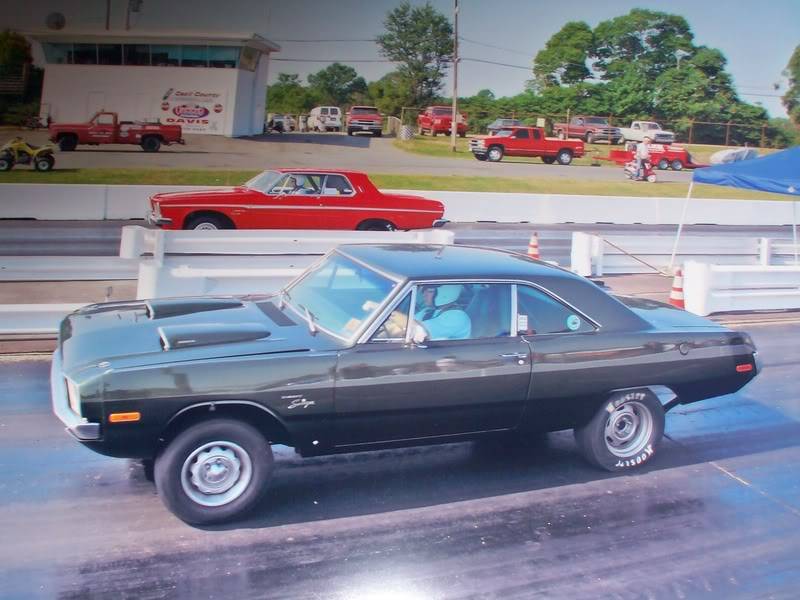

I forgot about my sons Dart. 72 Dart all steel stock body with frame connectors and a 6 point rollbar like in my car. It is a .030 over 400 (406) with the MP .557 cam and Eddy RPM heads. Performer RPM intake with a 750 DP. CPPA 2" headers and 3" exh. Has a 9.5 Dynamic converter with a reverse manual v/b. Uses 3.91's with 26 x 9.5 x 15 Hoosier QTP tires. Best et 11.45 @ 117.. Him and I make a great race. Usually who ever gets the lite wins when we race each other. Ron

Ron,that's an awsome pic of you and your son:yes:And those 2 Coronet's are very cool for sure.:cool::wtg:

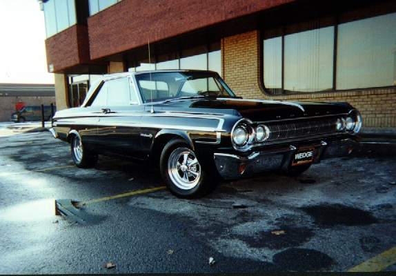

This is the only car that I have seen that was close to what I had.:reading: This car was for sale on the internet for a few years and was asking some crazy price!!! :no:

She's even more BEAUTIFUL than I had envisioned!!!
man what a sleeper, 67 Coronet dog dishes and a flat hood to boot. I love it. also lovin all the great pic's

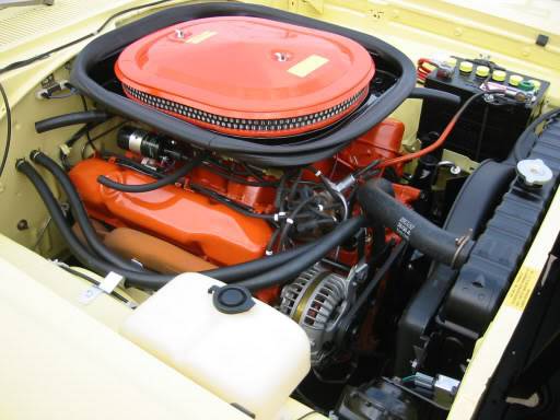

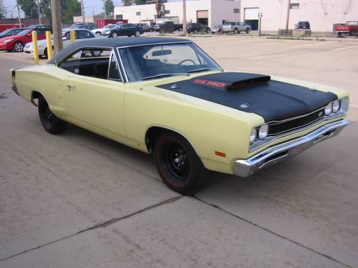

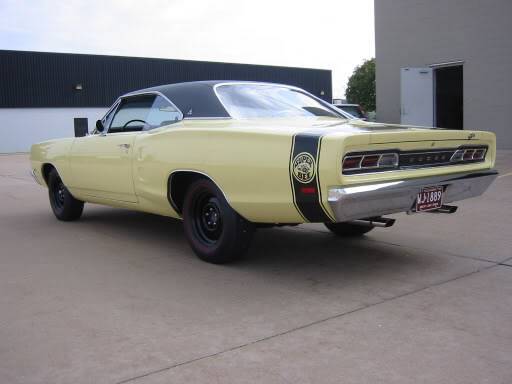

HERES my 69.5 a12 pure stock superbee 11.96 with red line bias ply tires and stock exhaust.
It looks as good as it runs!!!!!!!!!!!!!!!!!!!!!!! Very Very Nice Mopar!!!!!!!!!!!!!!!!!!
