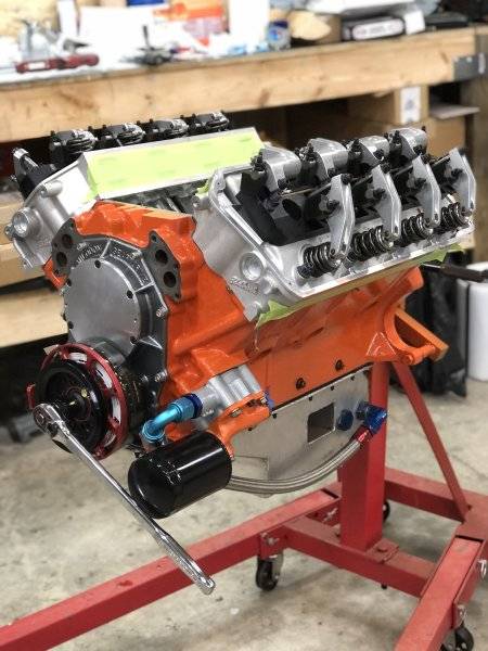

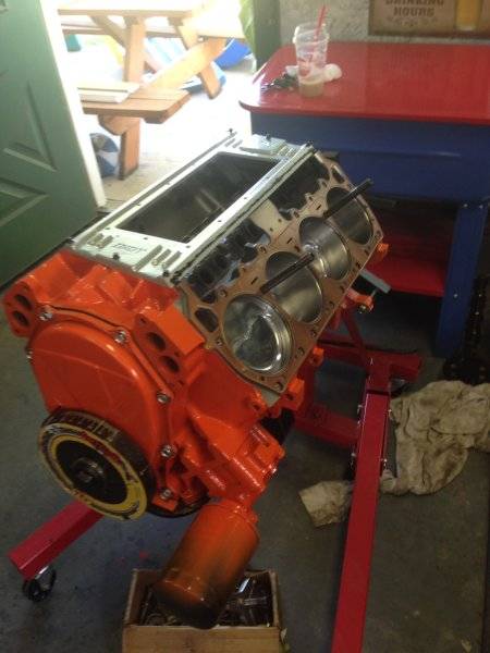

While we’re waiting on machine work, I’ll ask about some details: Engine color.
In the past I’ve always stuck with the stock 383 Turquoise and dressed it up like the 383 the car was born with. But since I’m clearly crossing into a real racecar performange range, I’m thinking of maybe going to Hemi Orange on this bullet. What do you guys think?
both my 440 & 505 are chevy orange . cheap and cheerful , easy to see any oil
Tex
I really like the look of the eastwood hemi orange. A little prep work and shoot it with a spray gun and it looks awesome. Motor in the roadrunner still looks great after 6 years.
