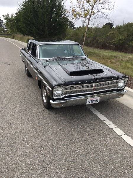

here's what a combination of pin on and hinged looks like..RO style scoop except for the 65's.

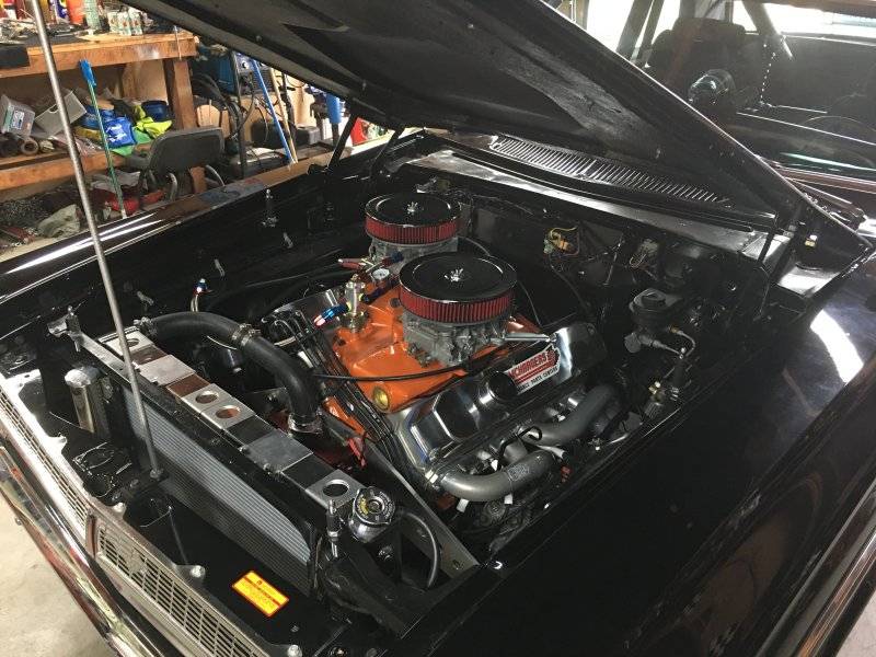

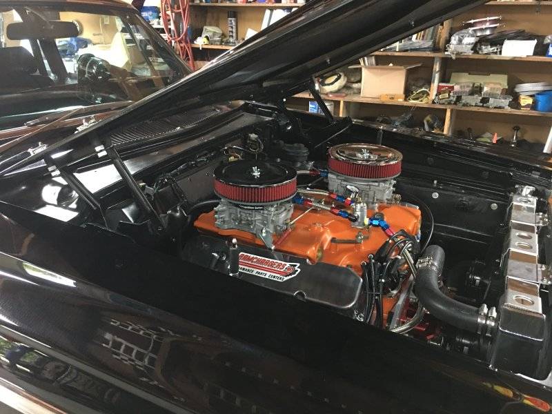

Oh YEAH! IF I ever do the unthinkable and go with multiple carburetors OTHER than some type of 6bbl, the 6bbl being what I am dead set on using, but IF, I would really like a ported, performance massaged Cross Ram!! I believe yours is such an intake?
Trickflow 270's with an A&A crossram, .272 @ .050 ! thanks.
biomedtechguy
Accelerati Rapidus Maximus
8:19 PM
Mar 28, 2014
30,712
46,306
South Louisiana
YES SIR! I will have the same heads whenever they get delivered :BangHead::rolleyes:...
Didn't A&A open up the runners for you or does their Cross Ram come "tweaked" as a bonus??

I bought my hood from UP22 in California . Fibreglass bolts on to stock hinges soft spring holds it up . 2 pins at front .
Tex
dvw
9:19 PM
Feb 16, 2010
6,854
10,820
waterford mi
My hoods have only required 4 pins. 2 Front, 2 back. Good to 150mph.

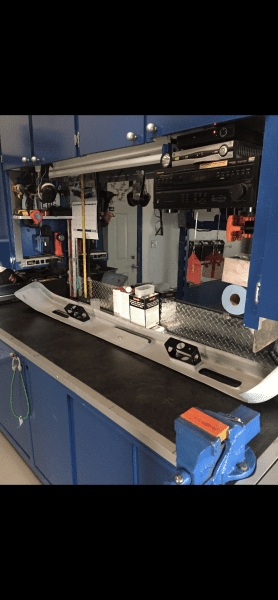

Front bumpers. A great place to remove weight. As far as brackets go I did something a little different. This bumper of mine was also a broken piece of dung to start with. I’ll attach a pic of it but basically what I did was encapsulate plywood to the inside and then secure home built brackets to it. Both ends are secured to each fender,
it’s rock solid up front there.
