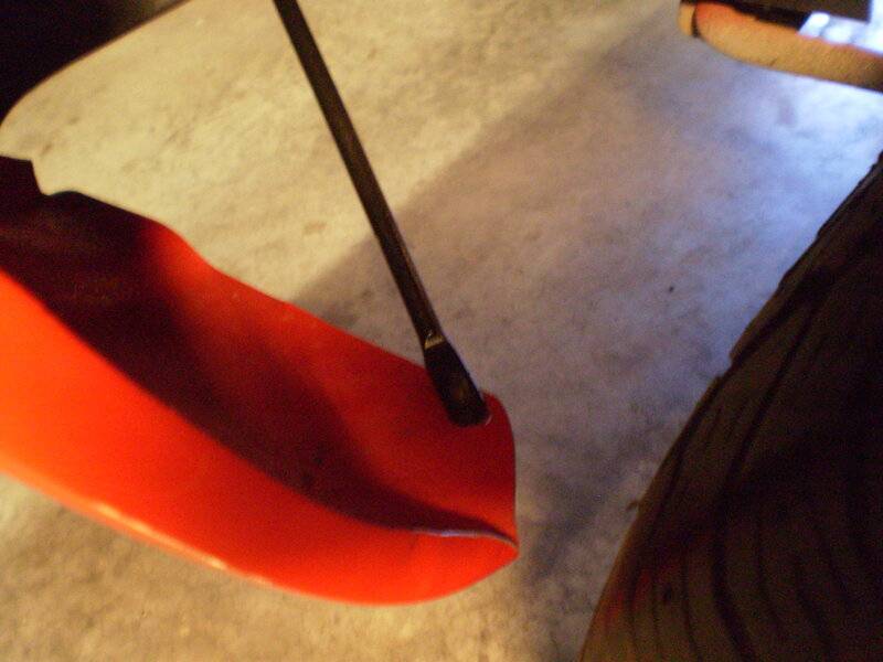

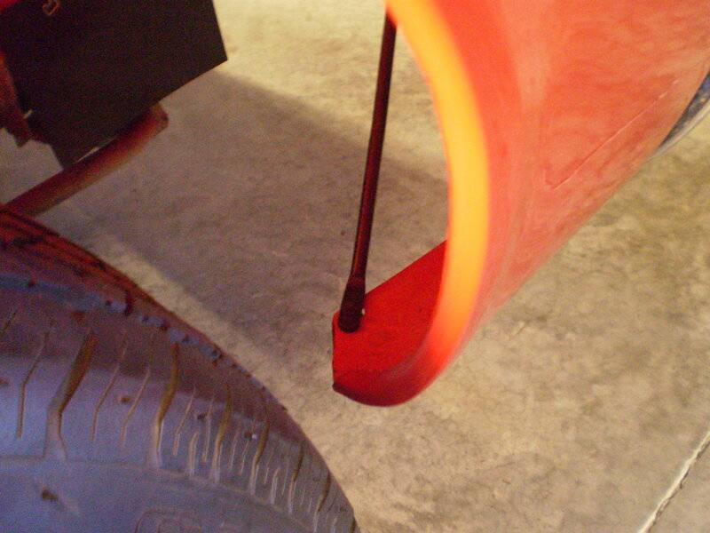

I have 215R70's on 15X7 rims on the front of my "64 Dodge and had to trim the lower corners of front fenders to clear, due to amount of front fender turn in. Same combo clears on my "67 Coronet because of less fender turn in.

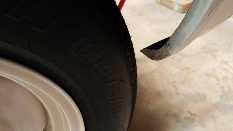

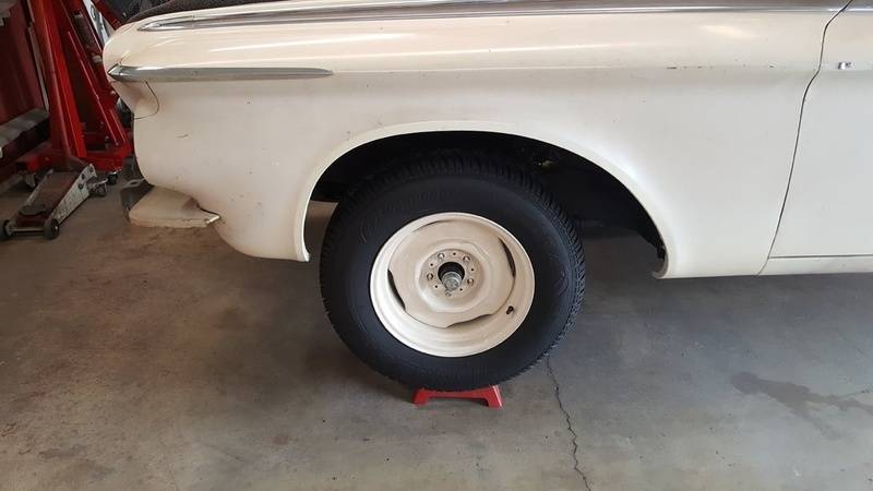

Cooper Cobras (Never had any problems with them making contact with the front of the fender opening.)
225/70/15 on 7"w 4 1/4" BS
The fronts run real close to the front of the wheel well opening when the wheel is turned inward but should be ok. Passenger side is closer than driver side. I'll probably massage that a little so it doesn't grab.
Wheels turned straight.

Mine looked like that too. but, when we were wheeling it back into my garage after getting it home from paint shop, one of the tires grabbed when steering was turned. It didn't hurt anything, but it sure caught my attention! My little body saw came out the next day for the trim.

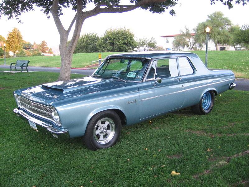

215/75/15 x 5'' American Torque Thrust light grey

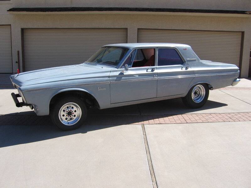

VW 165/80/15 x 4'' wheels. Weld or Centerline. Can't remember.
