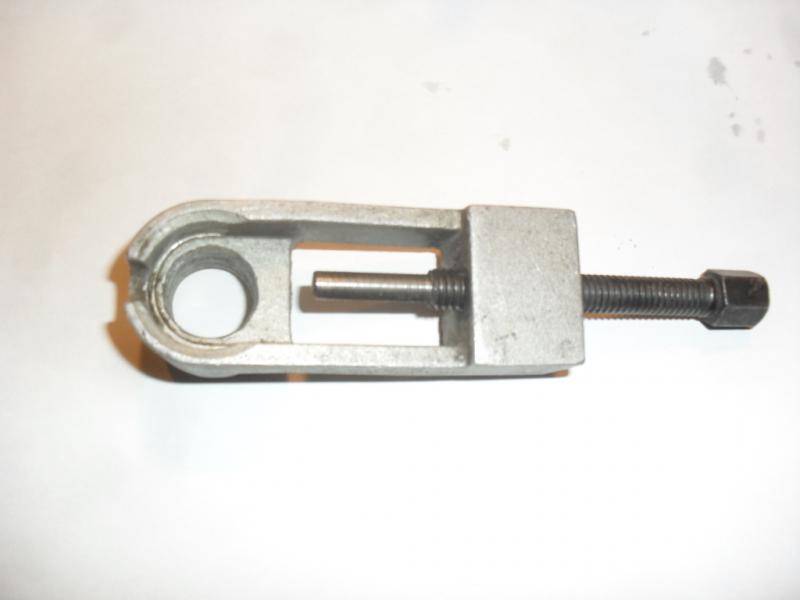

I am looking to rent or buy the Mopar special tool C-4113 to remove the solid steel pin holding on the lock plate on the steering column of a 1974 Dodge charger. The pin has been in there for about 50 years and I cant find any way to remove it without the special tool. Here is a pic. :

Oh WOW that's really nice of you. I am in Thousand Oaks CA in Southern CA. However my nephew lives in the Sacramento Area. I could have him pick it up and mail it to me, I would be willing to give you a deposit to insure its safe and prompt return? I did rig up a C Clamp solution but it wont budge. Maybe if I applied some heat? Thanks again.

That Miller Special Tool has been obsolete for decades.
Gotta find an old guy like me, that even knows what that tool is.
If you didn't picture one, I'll bet 95% of the people clicking on your ad wouldn't know what your looking for.

Need to find one somewhere. The manual says in BIG black letters not to punch it out but I dont know why.
