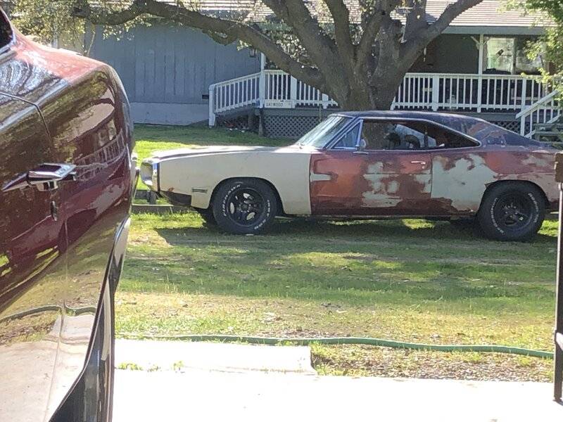

That is a good idea on the Anti-freeze. Thank you.
It is a mixed bag to report. The engine runs great, sounds great and performs great...But I have some valve cover leaks to attend to. For some reason, these blue Moroso gaskets don't seal well.
* The speedometer doesn't move. The cable spins, there is a 34 tooth speedo pinion in place and the cable is pressed to the back of the speedo.
* The tach is acting weird. It is dead most of the time but when it does come alive, it holds at idle but drops to zero when I rev the throttle.
* The gas gauge hasn't budged even with 5 gallons in the tank.
* The temp gauge is dead too. I grounded the purple wire to the temp sender and the gauge didn't move.
* The oil pressure gauge is dead.
The cluster is from the red car, Ginger. I pulled it because the temp and oil pressure gauges were not working consistently. The gas gauge worked though.
I have no front sway bar yet but I did take it out in the neighborhood. It feels remarkably stable. The steering is responsive, the brakes are great. I did 2 burnouts. It sounds great under throttle!
There isn't any pressure to fix all of these problems right now. I wanted to get it running and driving and I met that goal. I have a mechanical oil pressure gauge I can put in. I would rather have all the factory gauges working though. I have 2 other clusters that I can try but the faces of the gauges are badly faded. If they work, vinyl overlays could be used until I decide to upgrade.
I have to stop the valve cover leaks though. I can't stand to drive a car that leaves a stream of smoke like a crop duster!
