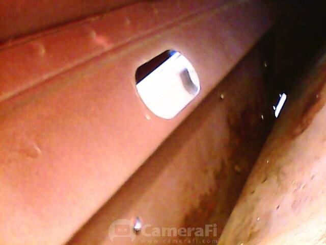

I rigged up a 1/2" rubber hose on my shop vac and went in through the hole on the firewall. I must have pulled out a 2 gal bucket full of mulch type of debris out of there. Rigged up air hoses the same way and blew it out both sides into the top of the driver's side fender and down into the passenger side fender. Removed the fresh air duct under the dash where it goes into the kick panel and vacuumed out that spot also. If both fenders were off it might be easier to get at any debris that you blow out.
This is what the inside looked like after cleaning out the debris.

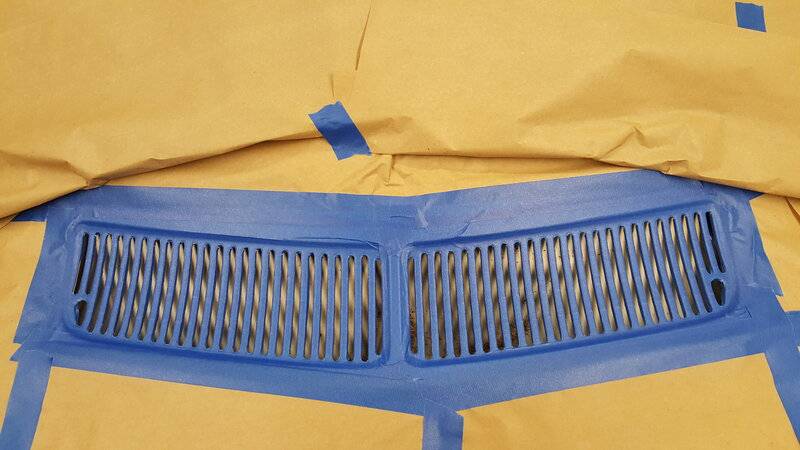

Then I taped up the louvers. Takes a little time but there's a trick to it. Tape completely over them, then use a razor to cut in the middle of each louver and fold it down.

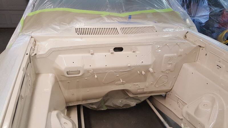

Then I used the encapsulator through the hole in the firewall in both directions and sprayed though the louvers for the rest of it. I did this right before painting the engine compartment. As I painted the engine compartment I sprayed that paint into the louvers. This way you don't have to worry about paint build-up on the louvers because they are taped. Remove the tape and paint the rest of the car when you are ready.
