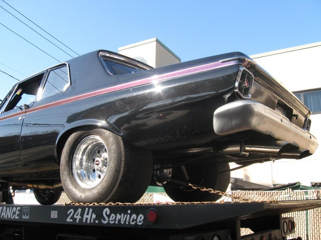

this is what I run on the streets!!!:blob1:
Do they hook good ? I was wondering if you have tried them at the track ? Ron
Not yet but I can tell you on the street they hook up pretty good without a burn out.They are made with new rubber compounds so they wouldnt be like the original ones.
I'll get it to the track next year now and give it a whirl!!!

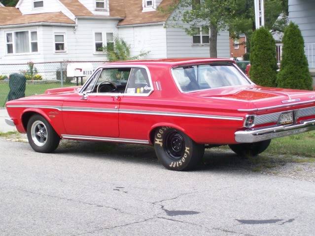

My 63 has the springs moved in,mini tubbed and the wheel lip removed.I have used the m/t sportsmans and then the sportsman PRO's without traction success.I will be trying the E/T streets next year.And YES,the 16.5 x 31's fit.

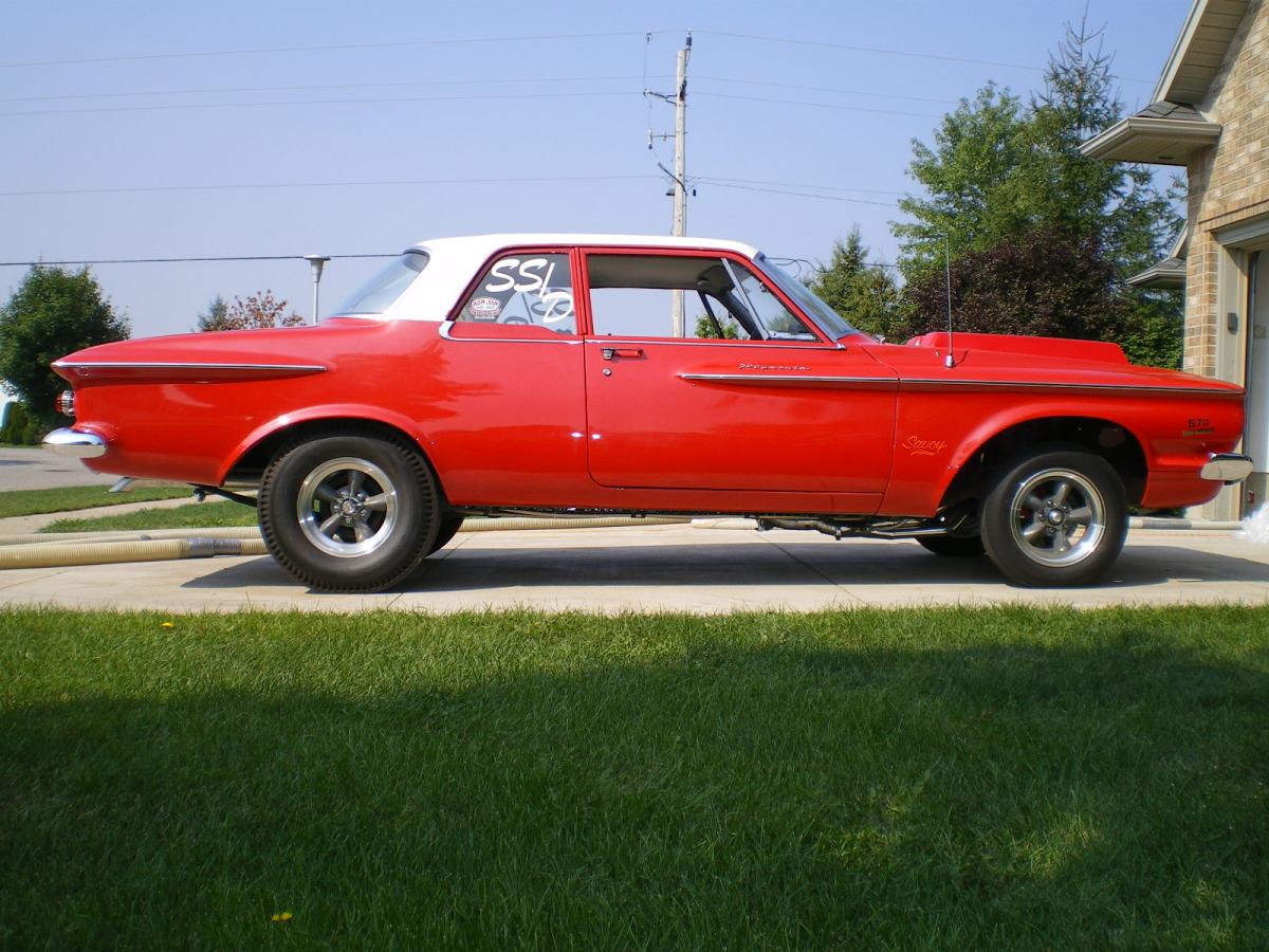

I trial fitted a buddy's set of 31x16.5 M/T ET Streets on the 65. They are snug, but fit.
