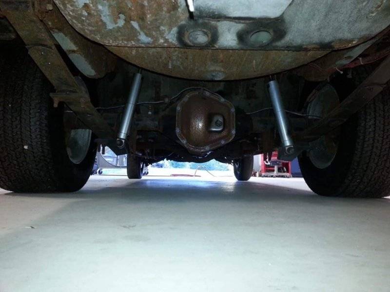

Dont need to tub to fit a 275/60/15

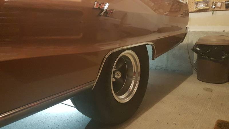

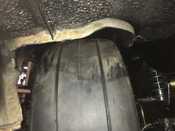

67 coronet stock wells
E7C486C0-090C-4D9E-A7E8-F6947A85C100.jpeg D1EAD214-3761-452D-A38F-F3A305E1757C.jpeg CBF5A401-7CC2-42A9-A02D-00C1B72E8F3B.jpeg

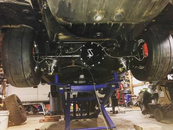

My '66 Satellite has 325/50/15 on 10" wheel 5" back space & narrowed Dana. Springs in to frame rails, mini tubbed.
Was this the widest rim you could fit and do you remember the width of the Dana

Not so much the rim width as the overall tire section width. Looks like a 12" wide wheel will just fit with a Phoenix 11.5W x 15 slick (15.5" section width). The 325/50/15 BFG's use the 10"wheel. The guy I bought the car from says the Dana is 47 7/8" flange to flange.
BTW the 11.5W's are too tall for the stock wheelwell. would rub on the front of opening. I moved the axle back 3/4".

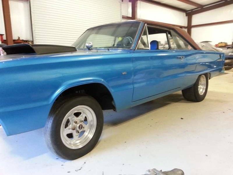

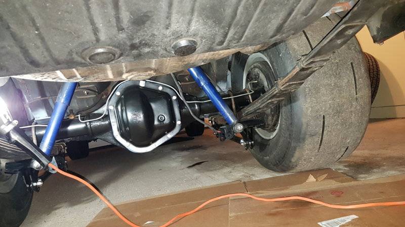

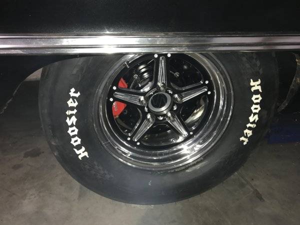

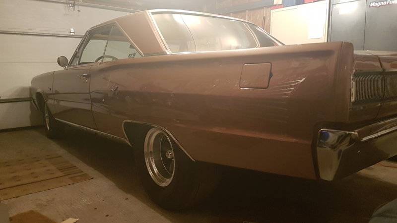

My 67 Coronet is mini tubbed , springs relocated , currently with.10" rim w/N50 ( 12.65 section width) on it and still have tons of room
