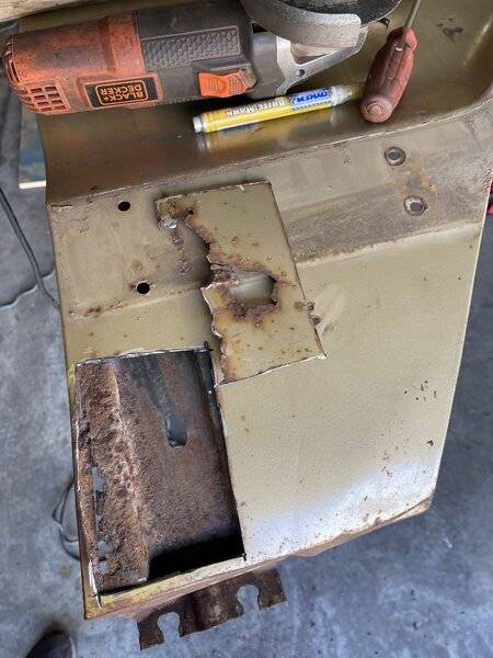

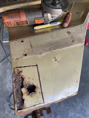

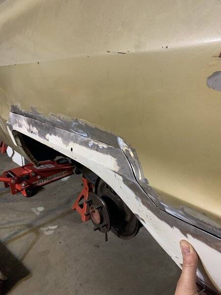

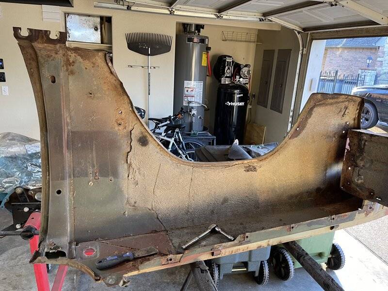

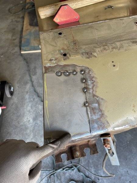

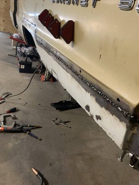

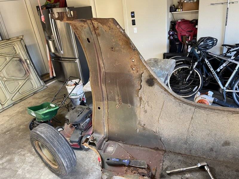

Left side quarters are done, time to weld up tomorrow.

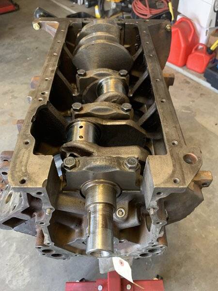

Crank is home again! (Let the jokes flow.....)
I never left the house!
Seems that way right? As I've cleaned and repaired...I'm finding out this car is in better shape then I thought. Its not cheap getting OEM metal and bits together.....but now that I'm butting stuff back, its helpful.....but no matter how well I bagged it, and took pics....I'm still hunting for stuff.....lol
You should try to put stuff back together that's been apart since 98!!

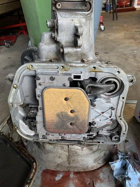

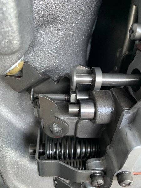

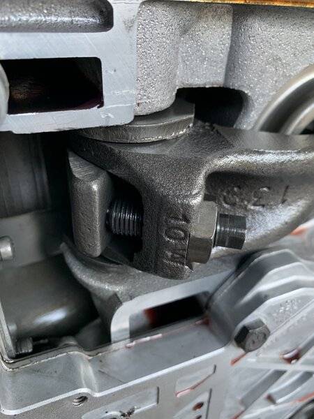

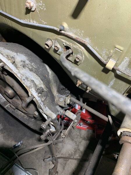

Ok, got the tranny pan off for a peek at the 40 plus year sit, and it’s rather surprising....
View attachment 1010960 View attachment 1010961 View attachment 1010962 View attachment 1010963
Except for seals, I bet it'll work! And they make products to help the seals seal :D

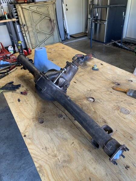

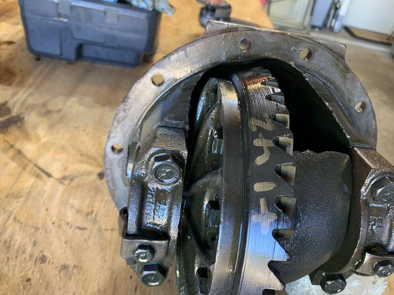

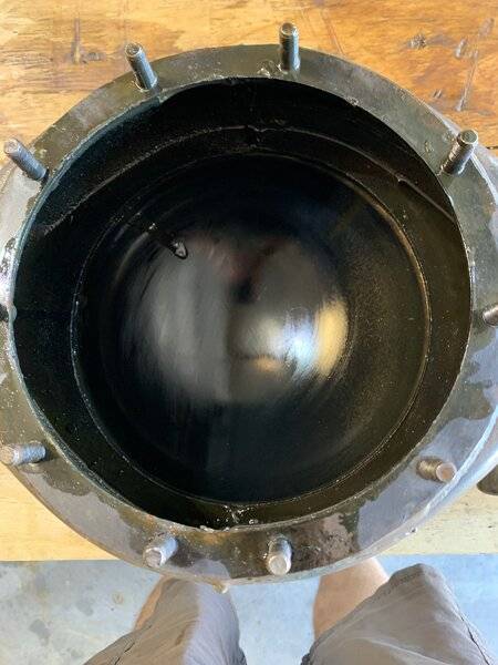

Well, the rear end on this car may be the best part ! Gear Oil was in good shape and as you can see , a bit of a miracle that it s this awesome after sitting for 40 years.

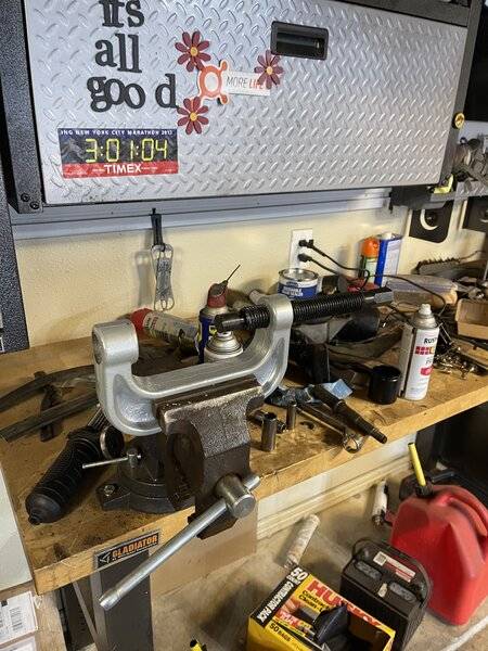

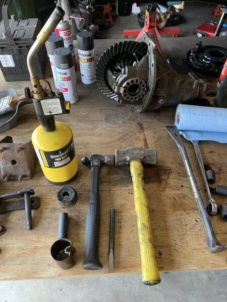

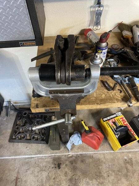

So for all those folks out there trying to get those beefy old leaf spring bushings out, my way requires just a benzo torch, a peen hammer , small chisel and 15 min.
1. Heat the inner metal bolt tube for about 30 seconds, but keep the flame just in the tube....do not ignite the rubber. In both my springs....the tube just fell out.
2. Take a medium flat head screwdriver to break the rubber out in chunks.
3. Use the chisel to create bead down any particular side.....the just tap it out

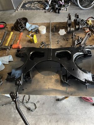

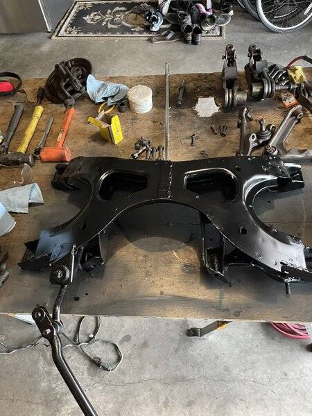

Did my k member with this combo . Been using it for a while on backer plates and my outdoor gas lanterns . Those things get hot as hell and are on 24 hrs a day. Paint still looks great after 4 years so.....

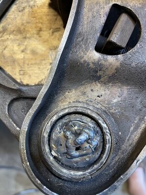

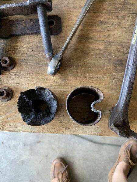

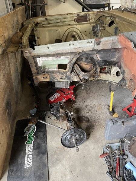

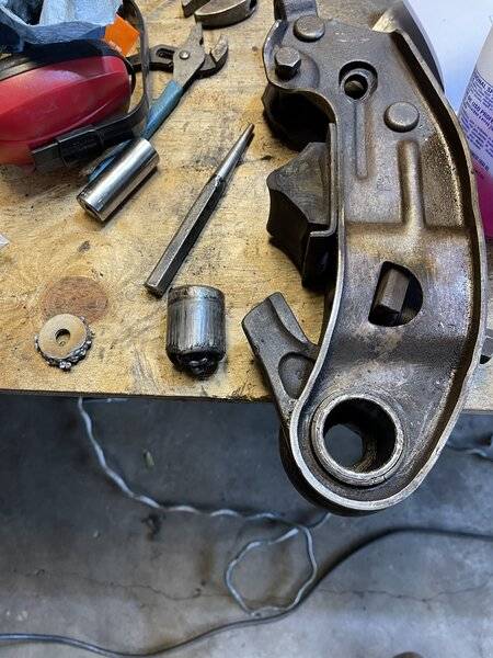

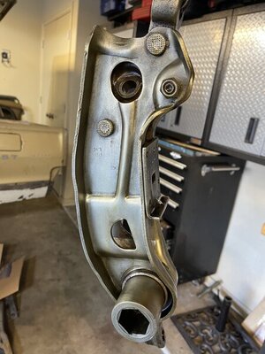

Got the LCA bushings out in good order. Tried the washer trick first, and was too afraid I’d burn through so I used a cold chisel to fold the rim of the bushing in and welded it up like a metal tootsie roll....came right out
8A19F3FA-D0C4-4AC3-B04D-CC2CCA62813B.jpeg FB9194BA-41CF-4153-A0D1-A577C4B074DE.jpeg 6D9F3122-D06C-49B4-80DA-8866100D69A6.jpeg 2E97A29D-8E06-469A-B294-41F949730913.jpeg

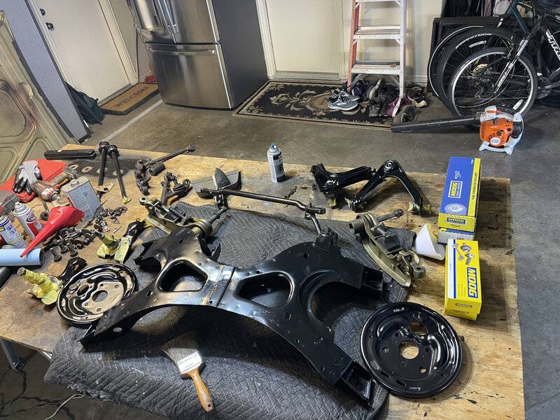

Well, at long last, the parts haven stripped, primed and painted. LCAs have cosmoline added and new bushings throughout. Reassembly is imminent.

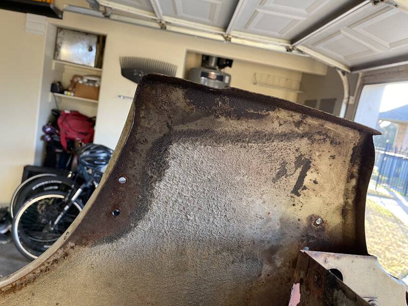

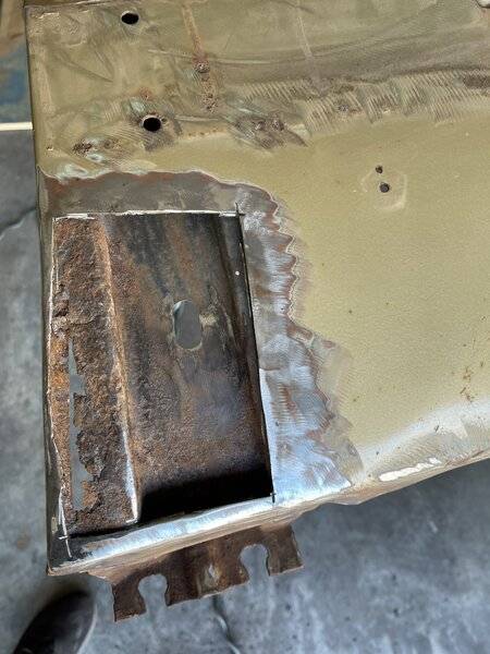

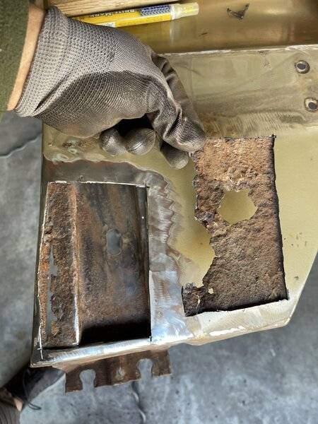

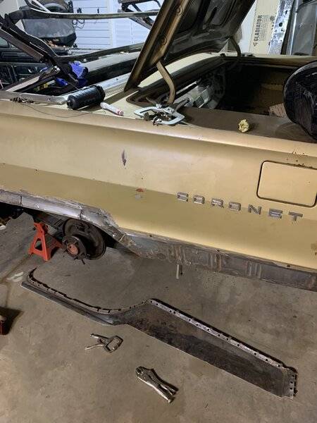

Passenger fender is off, and it’s way better than the driver.....home stretch on the metal work....one more quarter patch and this sucker is on to filler, primer and paint
