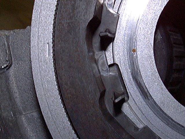

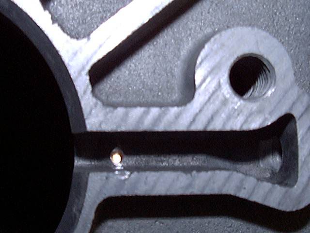

Would this be a new hole, or an enlargement of an existing hole? Would this be applicable to the A727?
It's a new hole, 727 shown.
Thanks for the pics. I'll do some more research. Just my luck to drill it in the wrong place. It looks like it's where the inner race bears on the case.

Yes it is new and I should have clarified in my first post that the hole is for the 727 but, may be applicable to the 518 as well as 904s.
Mike
