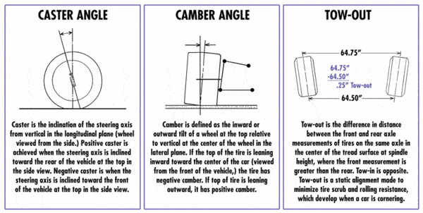

The simple diagram is not 100% accurate, as the adjustment on our cars is at the top, and not in the center of the spindle.
Sorry to hijack the thread, but how much additional caster can you actually get by using these offset bushings?
RustyRatRod is correct. To get more caster "+" you need to move the upper ball joint towards the rear of the car. More "+" caster the better the stability. Think of a bikes front forks...lots of caster. I might try those bushing to get more caster w/o buying the tubular upper arms.
thank you for your theory. i always wondered what caster meant.
