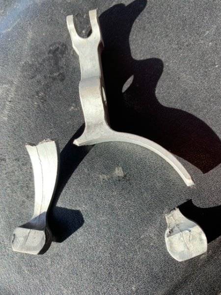

The RobbMc starter is currently in at a shop being looked at. Got a call that there is a fork made out of cast pot metal where when the solenoid is energized it pulls the fork back which then pivots the bottom of the fork forward which then throws the bendex gear out to engage the flywheel.

Yes, in 3 places. Called RobbMc to see if the Gen 1 fork is the same as the Gen 2 and was told they are different. So much for getting a new fork.
Yes, in 3 places. Called RobbMc to see if the Gen 1 fork is the same as the Gen 2 and was told they are different. So much for getting a new fork. View attachment 1617935
Someone from my local Mopar association sent me this information, not sure if this stuff will work or not.

Even if you successfully join this together, will it withstand another event like the one that broke it originally? It could fail at a different point. Now, if you have a machinist friend, you have a good pattern to scan for a CNC machined replacement made from billet aluminum. A big if!

I haven't enquired as yet about CNC machining however did leave a message for the professor who heads up their 3D printing department at our city's University. If I was able to get a new fork CNC machined from billet aluminum would the billet aluminum be as strong as the cast pot metal and if the same event that broke my original fork would the billet piece break of destroy the entire starter? It will all come down to final cost as I have emailed RobbMc to ask if they still make these forks out if cast pot metal or have they improved their materials. Not sure sure which direction to go right now. If I could find someone in Winnipeg who can make a new fork that would work best.

Billet aluminum is much stronger than a cast white metal. White metal is used to save on costs.
