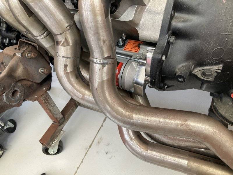

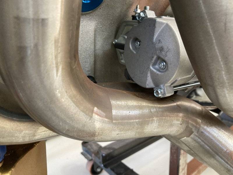

What's your engine and TTI combo? Mike and I are running similar combos. My engine is an Indy aluminum low deck wedge with the TTI headers specifically for that. 2 1/8 step units. I'm using the Powermster unit, 9523? I think. Tried all 4 clockings till I achieved the best fit. Still needed to massage one tube. Luckily for me the engine is on a stand, bolted to a k-frame plus the trans is on it too. The Indy block is wider too at the bottom compared to an iron block.

Tried the Powermaster 9523 however wouldn't fit and can't find any mini starter besides the RobbMc that will work and even then you have to make adjustments to the header tubes for clearance.
Bummer. Looks like the fun begins, or continues for you.
The starter issue plus all of the things you couldn't initially see wrong with the car upon purchase it's more of a money pit nightmare.
