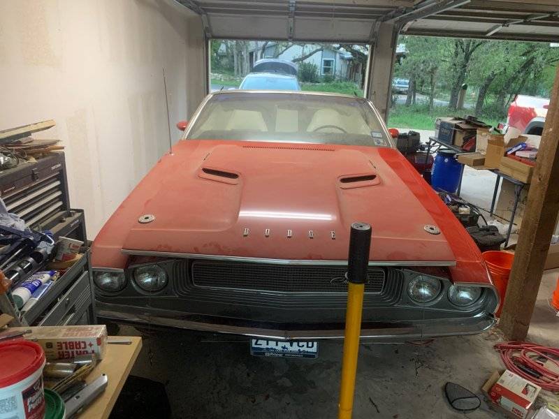

Well, Tuesday I had the car inspected in order to get Texas license & registration... It passed, Wednesday I got the title & registration... So I was able to drive the car legally.. First time the car has been on the road in about 15 years... It ran pretty well, ambient temps were around 100 degrees & the car ran slightly past half scale.. I drove it for about three hours testing it to see if it was ready for a road trip...
I've already replaced the fuel tank, blown out the lines, replaced the pump & filter... Rebuilt the carb... Rebuilt the calipers & wheel cylinders, replaced all the hoses & installed three master cylinders, all were bad... I finally took the first one apart & was able to repair it.. The residual pressure valve was installed backwards... Replaced the water pump, throughly flushed the cooling system
Anyway the old tires were practically new with least than 500 miles on them... But were 15 years old & the car hadn't moved so they were horribly flat spotted... Reading on the internet some folks said they would go back to being round after getting them hot & running them for 1/2 hour... Not the case..
So I decided rather than the T/A's or Coopers the local tire shop sells I wanted to try the Mickey Thompson ST radials... Summit showed them in stock... I called to confirm & to make sure they could mount them if I drove the car up there...
"Yeah, no problem, come on up" A three hour drive each way... I figured the six hours of driving would be a good solid pre-commitment test drive...
On the way up the car ran great, temps were fairly cool & the gauge never got close to half scale... I get to Summit & guess what? We can mount them but it's not gonna happen till after 6PM cause the only guy who installs tires comes in later... Just leave your wheels & pick them up tomorrow...........
Oh.. They are on your car??? We can't take wheels off your car!!!.......................... ARE YOU FU*KING KIDDING ME!!!
Needless to say things didn't get any better from there.... No way I was gonna drive all the way back to Austin on those other than round tires.. So, I found a Discount Tire nearby & told them my story, they tried to find me the tires I wanted through their vendors & warehouse sources.... No luck.. But if I go over to Summit & buy the tires them will install them....
I wasn't thrilled to be doing business with Summit after the earlier ordeal but I have limited time & a mission to accomplish...
So tires are mounted &I'm ready to hit the road.... I didn't even get out of the parking lot & the temp gauge was buried... WTH??? Anyway I spent a couple hours trying to cool it down & had no luck, every time I started the car within a few minutes the gauge was buried & yes the engine was really that hot...
Would up calling AAA first time in years... Towed me home 200 miles... I just had to wait five hours for a driver to be available....
I'm calling the adventure off... I'm catching a flight home & I'll have a transport deliver the car... Not how I wanted to do it but I can't afford to have it do this again in the middle of no where...

Trust me, I feel your pain when you are away from home and have car issues - you might be in the middle of nowhere trying to solve an issue and get parts for these old cars. Luckily, it has worked out OK so far for me, and FBBO has always been there to help too!
With your car having sat for 15 years there are bound to be a few issues. A sticking thermostat (???) certainly is not unexpected after sitting that long. Hope you work through it. Get a few more miles on the car and you should be in good shape. My issues happened in the first 1000 miles or so. You might be getting close now, so stick it out and get that puppy on the road!!! :thumbsup:
I've already changed the thermostat, twice... Trust me, I want to do the drive but I've already been working on the car for over two weeks.. No tools, no lift, having a heck of a time getting parts... And I have responsibilities at home that are getting ignored... I'll get it home where I have everything I need & get it properly sortedThen take a few days and have an enjoyable drive...
