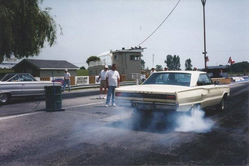

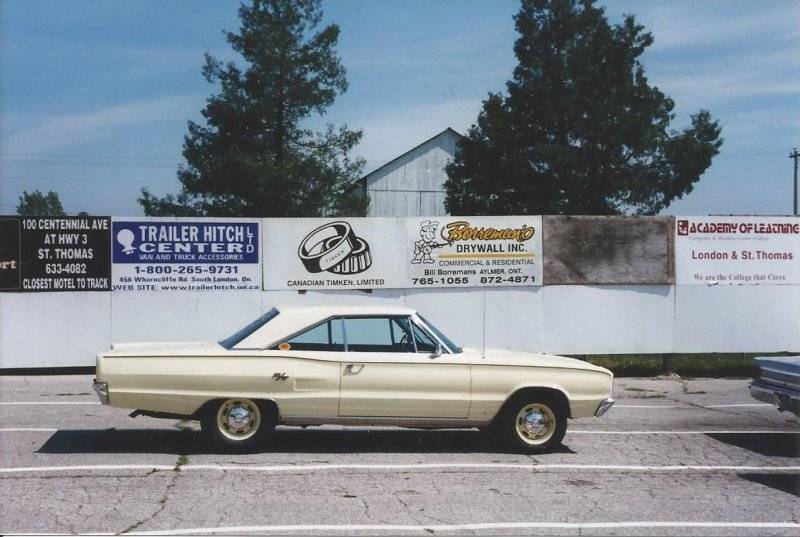

No, I don't actively race my car, although I have run it down my local track a few times. I mainly just wanted to pick the back end of my R/T a little bit. I think the 0455 spring has more arch to counteract torque squat on that side of the car. However, that higher arch will go away as the rear of the spring sags. It really needs to have a longer second leaf installed like the 0454 spring. This may defeat the engineered action of the spring for racing purposes.
