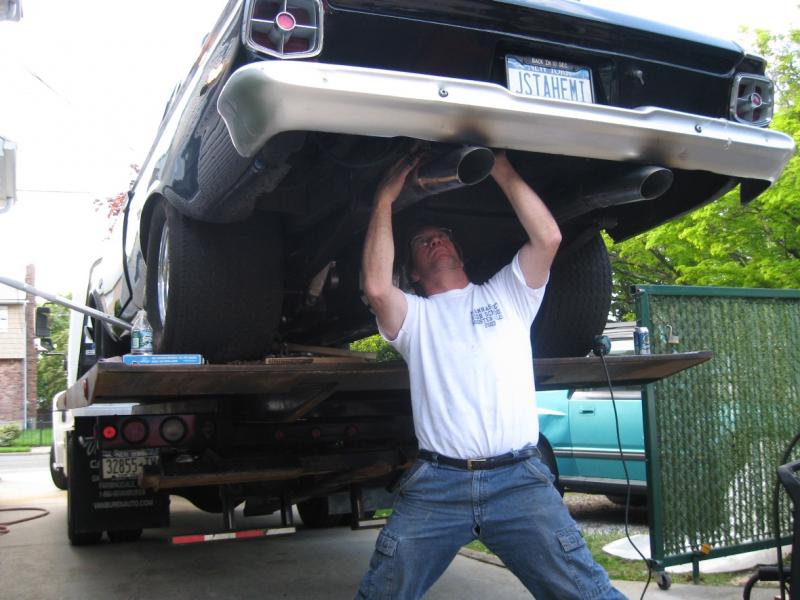

Depending on your HP level,the Walker line of Ultra flows are pretty quiet especially with an "X" pipe.I went with the Hooker aero chambers,but my HP is slightly more than average for a streeter.
