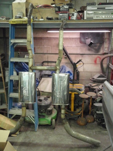

I installed a Pypes exhaust on my 70 Road Runner. It is a 2 1/2 x pipe system with headers and a stock 383. I think it sounds great. Some might think it is even on the quiet side, but it has no drone but still has a deep V8 sound...

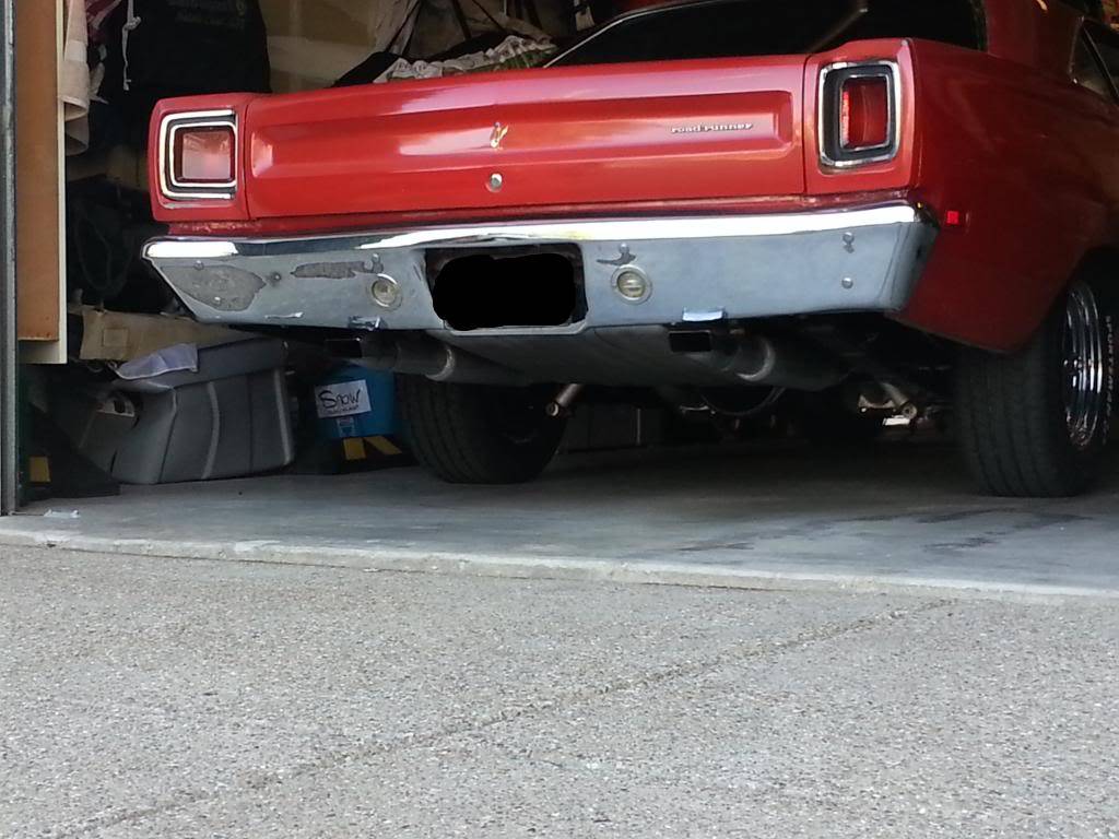

A buddy (member DPStark) has the Dynomax in his 67 Charger and I was impressed with how mellow it sounded. I got Dynomax with my 3" TTI system for my 69 RR but have no data on that yet. On my 71 Ranchero I put 2.5" dia 25" long Thrush turbos on and it was extremely quiet. I just ordered them from Summit and the price was maybe $40.00 ea. Not stainless but very quiet. Thinking the same for my Dart or a repo system.
