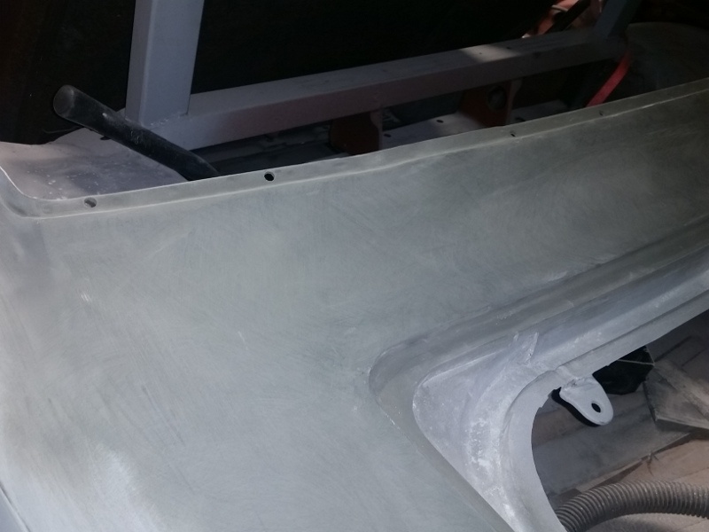

Back in the shop for another round at this area . . . it's giving me a fit . . .
Sometimes it's best to find a new tool for problematic areas, are you only using the rigid wooden flat board? An area like that might be better blocked out with a contoured foam board that will conform. They're rigid enough to level the panel but flexible enough to bend making it a lot easier.

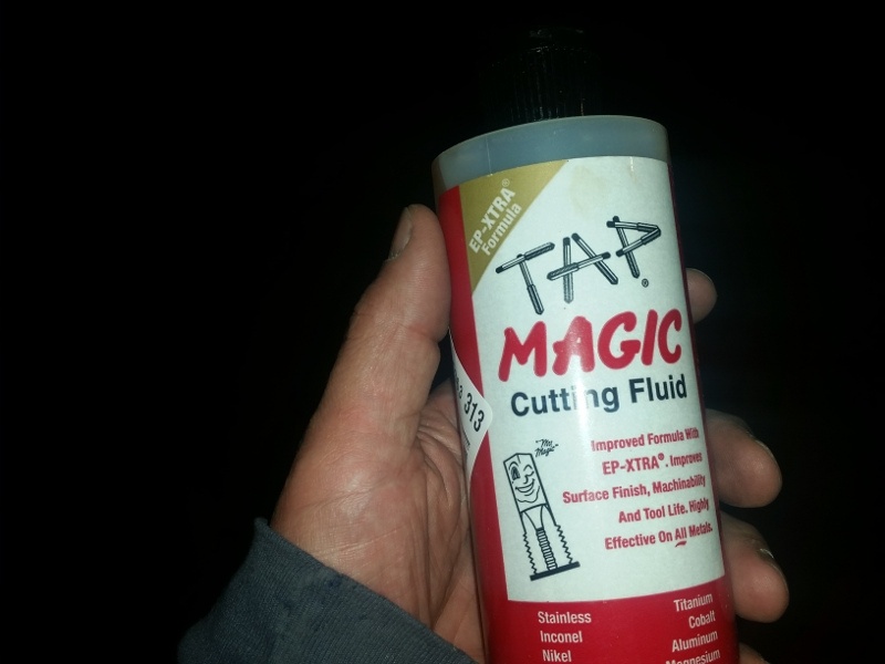

Not sure if anyone has mentioned this Larry but A little advice, look for some tap magic. WD40 is a poor lube for tapping holes, tap magic is made for just that and works great.

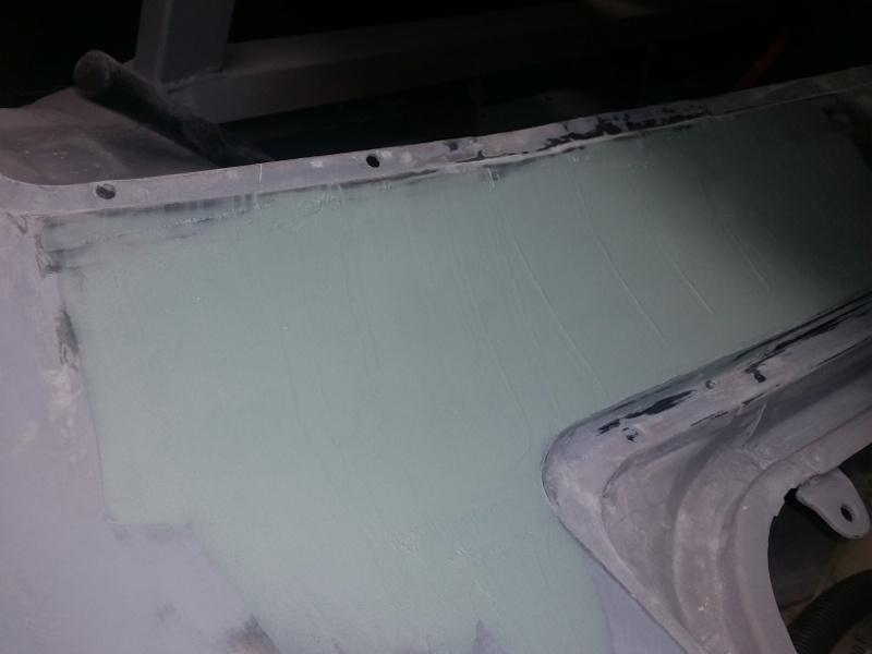

Got in the shop and was able to spend some more time on the bodywork that has been giving me a fit . . .
And I think I've got it close . . . this corner has 3 different contours all combining together . . .

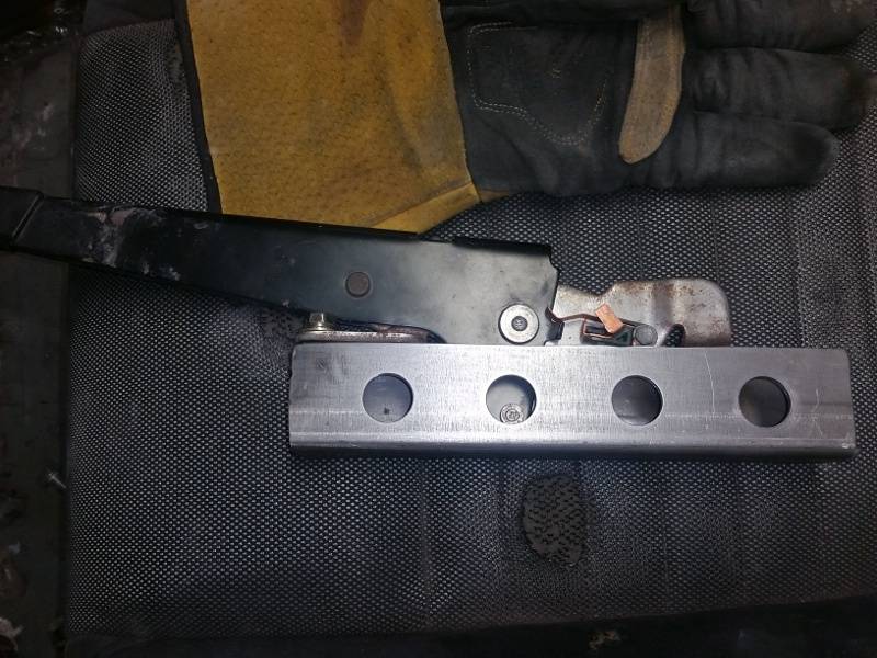

Worked on adding some fer racin' holes in the bracket that'll hold my parking brake . . .
Coming along nicely . . .

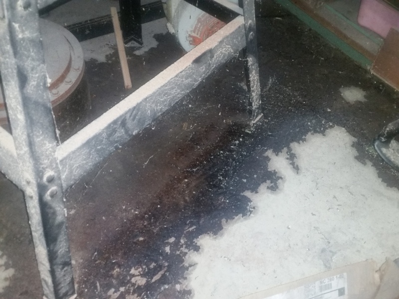

Went out to the shop today and found this . . .
Now to try and track down the source of all this water in the shop . . .
Look what showed up today . . . Ordered it last week ( after your referrals ) . . .
I've got some "tap magic"
Ooops . . . . that's the "other" type of tap magic that I had on my mind . . . how about this . . .
So I'm ready for my next battle with tapping threads . . . Thanks for all the advice FBBO friends . . .

It'll practically tap itself with that stuff Larry!
