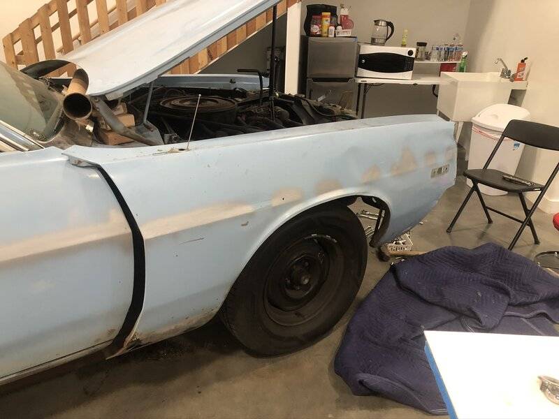

Today, Saturday 9th May I finally got some time for the car. Well, I made some time after riding my local trail...
GET BACK ON TOPIC!!!!!!!!!!

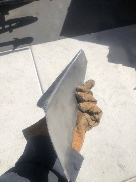

Ok, so I cut another piece for my lower quarter... and narrowly escape decapitation from a DeWalt cutting wheel!
The other bit flew off outside the shop. It's saturday evening so nobody is around and I'm glad. That went boom for sure.
Using my tried and tested technique, I scored the metal with a knife, and began shaping it with pliers and a hammer and dolly.
It was then, that I realized...DOHHHH!!! Same dang thing as the other side!!! I can't weld this in, without applying weld thru primer to the back side of it. Jeez...even monkeys can learn from their mistakes....
I coated the new piece with weld thru, and ground down some more of the trim holes. I used my little Harbor Freight palm sander with some 180 grit and I stumbled upon a way to be able to see that body line more prominently, using said palm sander and stopping at the ridge gave me a defined edge where gloss and matte meet... This really helped to fathom what needs to happen with filler and that body line. Excellent.
I then cried into my coveralls when I moved forward and remembered the area on my front fenders also known as Dent City, Utah. Booooo
I have to figure out how to remove the front fenders. They need a lot of love in Hammer and Dolly form. Also some welding. I became despondent, so I posted on here, and I think I'm going to go and do another mountain bike ride. Sunday, I'll get busy with the car.
Not very exciting I'm sorry, but tomorrow will be better! Cheers! Stay Safe!

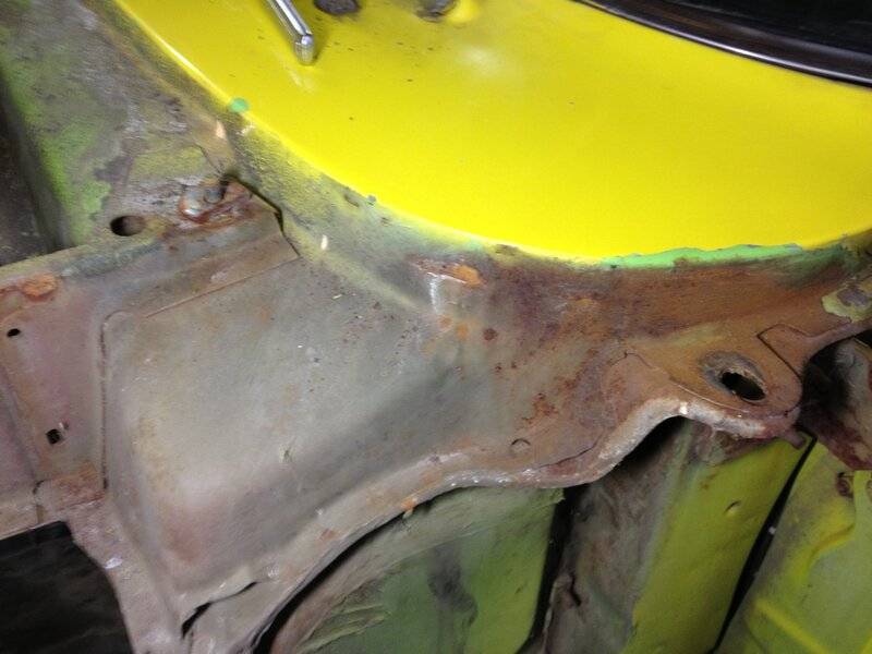

Front fender removal is pretty basic. Assuming your fenders are like my Road Runner (I think the design will be very similar), do as follows: There are a row of bolts just under the hood line on the top of the fender. Also note the two side by side that have slots for adjustment.
Furthest back there is a nut. Take note of the shims under the fender here, as this is what is used to put the back of the fender into proper location height wise. Here is my Road Runner (driver's side) with the fender off.
There are also two nuts at the bottom of the fender behind the front wheel. These also have shims to shim out the bottom of the fender and align it with the door. Again, take note of the shims here.
Your car may have a bolt on the edge of the wheel well:
Finally, you have some at the front of the car behind the grill near the radiator support. These are also slotted and allow the front of the fender to move either towards the center of the car or outwards for alignment with the hood.
I'm sure I missed a few details, but the above are the basics. Take careful note of the alignment (take pictures of each bolt that adjusts the fender too) so you can get everything aligned easily again. When I had to reinstall both fenders and hood, it was actually a lot of work to get all the body lines to line back up!

I finally welded in that dang lower quarter this afternoon...
It doesn't look half-bad considering.
I rolled the car outside, so that I could sweep the shop, but also so I could power through some sanding - grinding off the remaining trim pins, and taking some 180 grit to the rocker panels, without covering my shop in car shizz. I also welded up the last of the trim holes on the car, but left the fenders, because I'm taking them off and will do that then. Here she is as she sits today...
I'm trying as hard as I can to look at the car in "small manageable pieces" - although the last four photos would not suggest anything like that. But I decided I need to finish the metal work on the driver door and passenger door, before I get to filler work. That way, I'm sitting at the same point on the car, albeit from the doors back (fenders are so bad it's almost a totally different project).

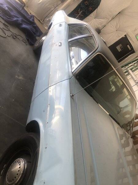

So the passenger side door crease was tackled.
I've seen this done on the internet (yes, I'm a YouTube Certified Body Guy now), so I thought I'd give it a try...
Pulling, hammering around the edge of the low spot...using the stud welder to heat the middle up (I don't have a torch in my shop) pulling, hammering.... it sort of started working. I took the door card off earlier and swore at the car, because behind the outer door skin are a couple of huge cross members - right where the dolly needs to sit.
I tried everything to get my dolly in there, but all I succeeded in doing was to lacerate my hand on the window regulator sprocket. Thanks, car.
So I got out my "Redneck Engineering" book and here's a pic of what I used to get behind that crossmember..
Did it work? Well, yes. My low spots were considerably lower, to the point where 1/2" of filler is not required. I was happy with the results.
So, this isn't too bad. I have my eyes firmly fixed on that horizontal body line, for I know that if I jack that up, the whole door, and therefor the whole car is going to look decidedly amateur and done by an Englishman with no idea.....ummm...I mean....done by someone with no idea. But I think with a skim of filler, it'll look alright.
That's it for today. I put a good 5 hrs in and it felt like I only did 5 mins of actual work, even though I wasn't interrupted once. Progress is progress though, as you guys have said. Cheers!!

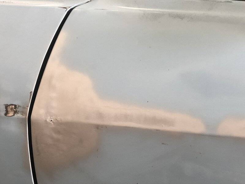

At 5pm, I decided to tackle the other dent in the driver door. I wish I hadn't started it...
It looks like it has a "bow wave" and it's deep. Urgghhhh
I used a metal ruler to see what the heck was happening. It gave me a better understanding of where the lowest spots were.
It looks like a disaster and indeed, it felt like one...but eventually I pulled it out enough to think "filler can do the rest of this crap". A quick coat of zinc galv compound and that'll do.
I'll weld up that little hole and do a nice job with the filler. The dent was originally very deep, maybe 1/4" deep at its lowest point. I know this looks like a dogs breakfast but its a little better in reality and I'm confident I don't need to mess with it too much more - unless I separate the door skins, and let me tell you, there's more chance of me having dinner with Marilyn Monroe than me separating door skins!!

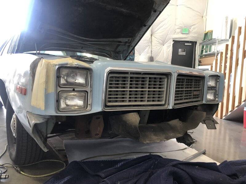

As you may remember in earlier pictures, someone before me decided to drive the Monaco into stuff - kinda like those old cop shows I was talking about at the beginning of this thread...y'know, where the perp and the cop car ultimately end up driving down an alley, crashing through randomly placed cardboard boxes and fruit & vegetable stands that have absolutely no place in aforementioned alley... well, someone in Salt Lake City would have been witness to a Wedgewood Blue '78 Dodge Monaco destroying something fairly hefty. The driver even managed to hit something with such accuracy, that it went in between the fiberglass nose section, and the fender, turning the fender into the dentyest dent ridden dent-fest I've ever seen.
The fender needs serious love and the nose section was broken pretty good. I have all the pieces and the headlight bezels, it's just a question of fiber glass repair....so for some ungodly reason, I decided the nose section must come off. (I have a feeling this is going to be a bit of a 'mare)
It was.
Firstly, I took out the turn signals..
The lenses (no longer available) are held in with those two screws, and the housing is held in by two screws up top, just barely visible. One was completely frozen so removing that took 20 mins with a drill at an awkward angle so I didn't marr the chrome with the chuck of the drill.
Then, after four of the same type bolts as on the rear bumper, I removed the front bumper - not without accepting seventeen tonnes of crap into my eyes, even with my glasses on.
There's a lot of this rubber/plastic splash guard stuff missing under here, I'll have to make my own I guess.

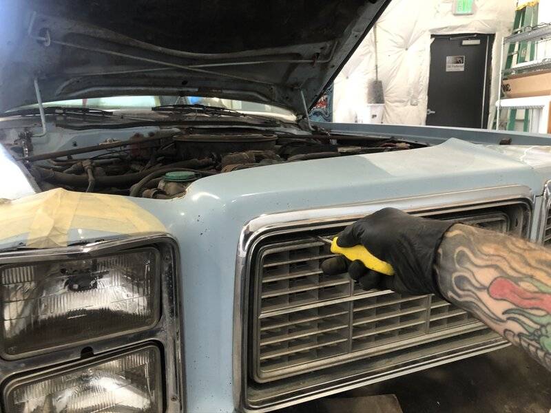

Then, I nervously removed the grille, which was held in by seven screws. It should be held in with eight, but of course, one was missing.
The grille is in excellent shape, just needs a tidy up and repainting of the fake chrome - does anyone have any recommendations on chrome paint?
This grille is not available anywhere. I've seen one for sale on the facebook page I frequent for these cars, but it was in North Carolina. One for sale. One. Why do I do this....
It was then, that the nightmare began. removing this nose section. Chrysler hid all the nuts deep inside recesses between inner fenders and the nose cone itself. The fiberglass nose section has six threaded rods protruding from it, which are slid into six mounting holes and backed with a stupid thin sort-of-nut that feels like it's made of tin. On the passenger side the only reason I actually removed that side is because it's mostly destroyed and there are holes everywhere. It was still a bear though.
The driver side was a little less horrific, once I had removed the plastic duct work for the air intake to the carb...it allowed me to remove the weird nuts, this time, with only minor cuts and bruises. Some pretty good swear word combo's too. Eventually, the dang thing came off
Now you can see, on that passenger side, the damage to the fender. Just how in all pluperfect Hell did an object get into that gap and make that much of a bend in the leading edge of the fender?? It blows my mind. It also annoys me because I have to fix that shizz now. No fenders available either.
Here's the nose section. All in all, a despicable job this evening to remove this. Of course, there's no "find another one" of these, I have to repair it. Which I am really looking forward to. Yeah, right.
This is not my finest hour. This picture gives me anxiety. I am grateful, at times like these, that I have taken about forty seven million pictures so I know how it all goes back together again. it still gives me anxiety though. I hope I can make that fender look ok.
So, that was 3.5hrs worth. An absolute bastard of a job, made a little easier by my nice clean organized shop. If I was working how I used to work (in total chaos) I think I'd be crying this evening. Instead, I feel grateful I have my health, and I have the car I have wanted for so many years. Tonight I hate it. But then, I love it as well. It's not its fault that it was built in Detroit, in the winter, with no regard for rust proofing, or indeed much quality control. It's not its fault that the Chrysler corporation couldn't cobble one decent engineering degree between the lot of them. And it's not its fault that it's now my car...but I hope with a little persistence and some better parts, that it'll live again soon. Cheers!

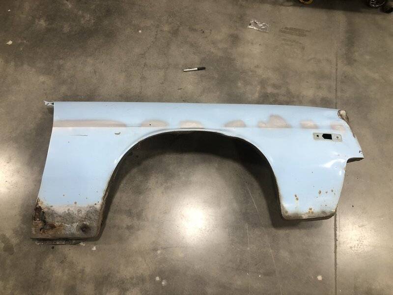

I had a quick look around the internet for a fender Gary. I am sure you have exhausted all of the searches yourself anyway. You are right, not a lot out there for these cars. Looks like fixing it is you only option unless you get lucky somewhere. Good luck and I look forward to seeing you take that on.

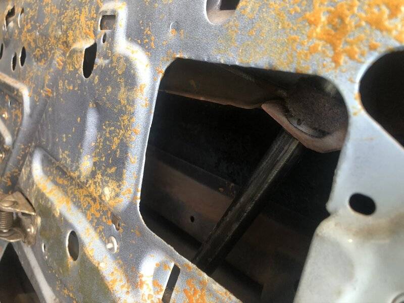

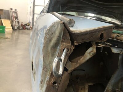

Now that my car knows who's boss, I decided to get heavy on this irritating dent on the front fender. What I really wanted to do was hit it, with a ten pound mallet. A lot. But what I actually did was try and use what bits'n'bobs I had laying around to make a bracket - this is the mounting plate from the rear bumper, that fits inside the fender, with some bolts to somehow pull the dent out.
Yeah, that didn't work. The bolts didn't have enough on them for a hammer to catch a good "whack" with.
So I found this eyebolt, and put that in, with the plate still inside the fender...
This sort of worked. I put my pickle fork through the hole and got "medieval" with it...
Mostly, I made a lot of noise and the shock waves through my hands were a feeling to behold - the dent did start to come out a little but really, it was a spectacular amount of ft/lbs for almost zero accomplishment...so I stopped and thought some more.
I have a stud puller. Somehow if I can unscrew the end part, and feed the threaded part inside the fender and bolt it up....no no no, this is getting too complicated...
As before, I loudly enlightened the car that it's mother was a rather unkept lady of the night and that if it messes with me again, it is going to see the business end of a crusher.

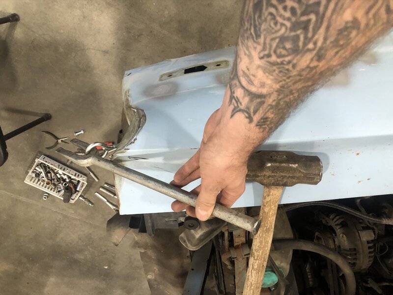

With a skeptical idea about the next two hours being "fun" I began snapping off old bolts...I mean, removing bolts.
It wasn't long before the fender started to move east, highlighting yet again, Chrysler's incessant need to put awkward bolts in awkward places and over-engineer stuff when it's not that necessary - I tell you what, there will be a few ounces less weight when these go back on, I am NOT using that many bolts!
With some tugging and pulling that looked and sounded very similar to the "Rhino Birth" scene in Ace Ventura Pet Detective 2, the fender came off. Hundreds of thousands of pounds of rust fell to the floor as well, but generally it wasn't too bad under here.
Here's the fender. The horrible, nasty ugly, putrid fender.
As you all know, I have my work cut out. I have to fix this...
Thanks for taking the time to search Jase, I really appreciate that. Yes, parts for these are like hens teeth. Or that suitcase full of money just laying at the side of the road, which we all think is a real thing... I am hoping one day, someone will start pressing these but how would they? The old tooling is long gone. It's crazy to think these cars were ten-a-penny thirty years ago, but today, nada, zip, nothing, f-all. One would expect rarity to correlate to value but of course, I picked the rarest cheapest car in the world to be enthusiastic about. Ahh well, it's not about money, it's about the car, which I love. I can't wait to drive it again......in a Galaxy far far away...

I am no body man, but I wonder if you used your eye bolt and attached a small come-a-long to it to try and pull the dent? That might help you get most of it out. A come-a-long is pretty cheap to buy if you don't have one.
